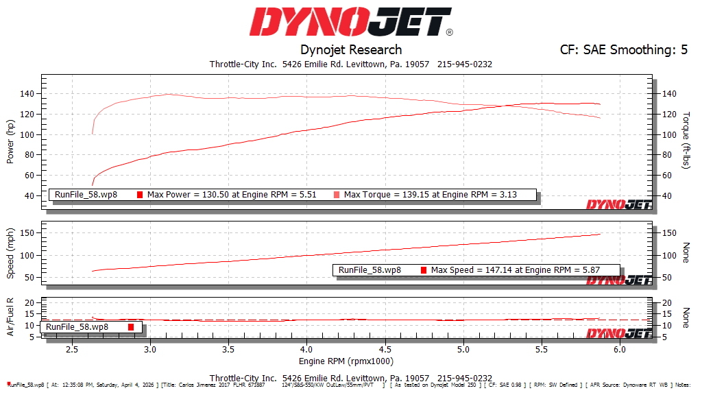

Default The difference a 2 into 1 makes
Switched from a Khrome Werks Dominator (2-1-2) to the Khrome Werks Outlaw (2-1). Picked up 6 HP and 3 TQ. The bike was originally a 107. Did the S&S 124 kit (comes with their 550 cam), stock heads, stock throttle body and stock injectors, S&S aluminum intake manifold. Was originally putting out 124hp / 136tq. Now with the 2 into 1 (only change) it's 130hp /139tq. Plus sounds rowdier (more chop), I should have gone 2 into 1 sooner.

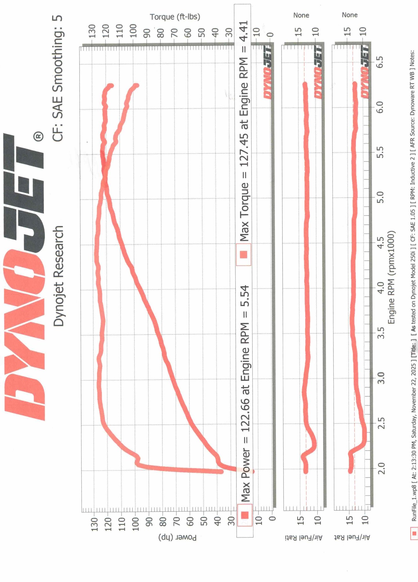

Default Update 2023 RGS with CR484
2023 RGS ThunderMax tuned by Thunder Valley Cycles Phoenix, AZ 11/22/2025
122 HP
127 TQ
Cycle Rama CR-484
Feuling HP+ Lifters
S&S Sidewinder Race Only with DB Reducer installed
Screamin Eagle Extreme Wedge
S&S Quickee adj pushrods
SE 64mm TB and manifold
FM 5.5 injectors
Intake breathers vented to ground
Trask Check M8
A1 Cycles vented dip stick
1275 Clutch Springs
Thundermax Tuner
Star Racing Compensator
