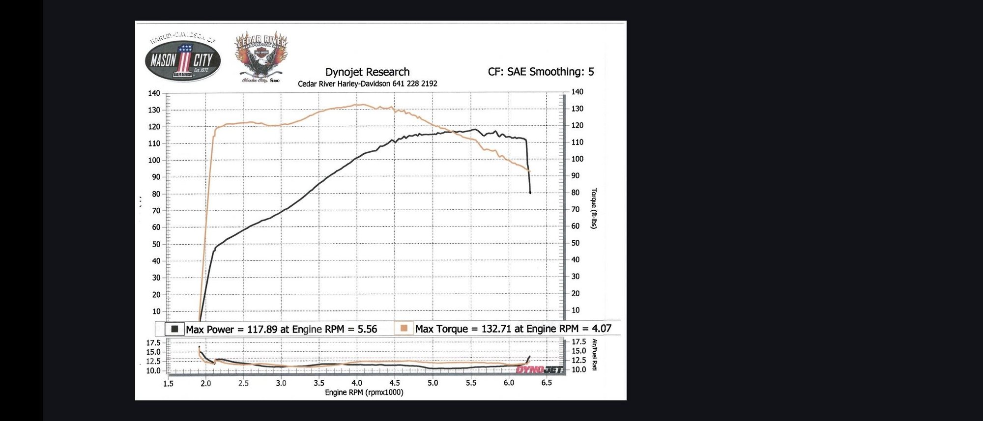

107 to 119 kit, Star Racing 30/30 cam Tab Performance 2 into 2 header with the Khrome works HP+ Slipons with the spoon/performance baffle.

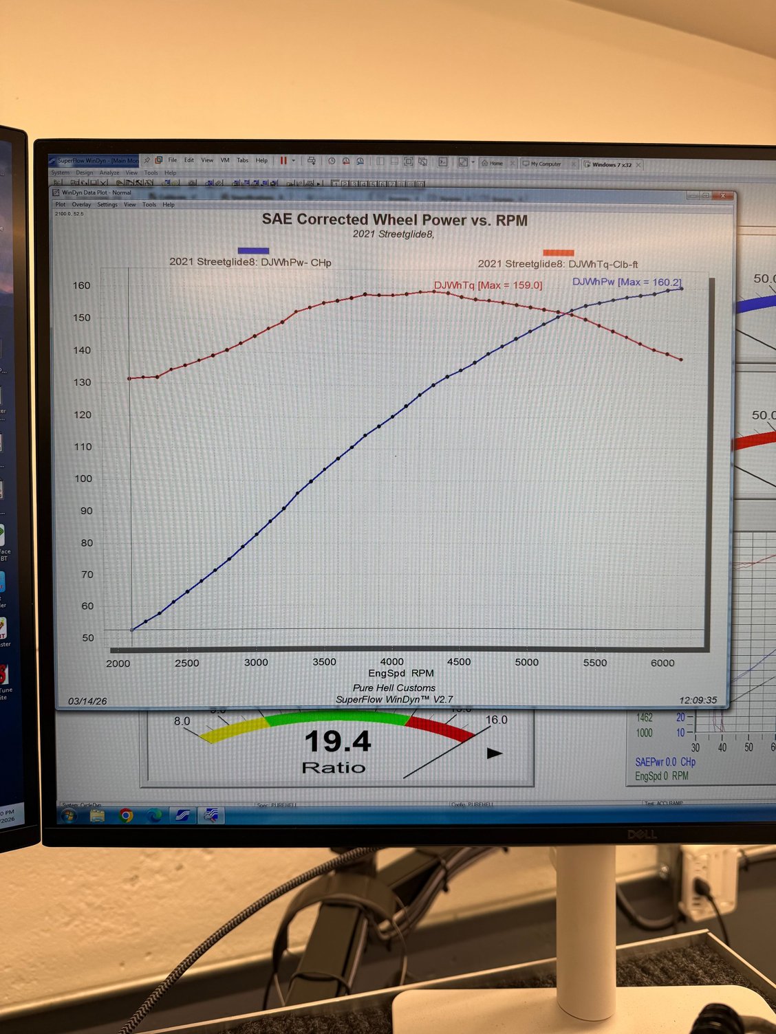

21 Street Glide, Ward 130 cu.in kit, Thundermax, Khrome Works 2 into 2, HP + mufflers. Built and tuned by John Helvie, PureHell Customs, in Culpeper VA

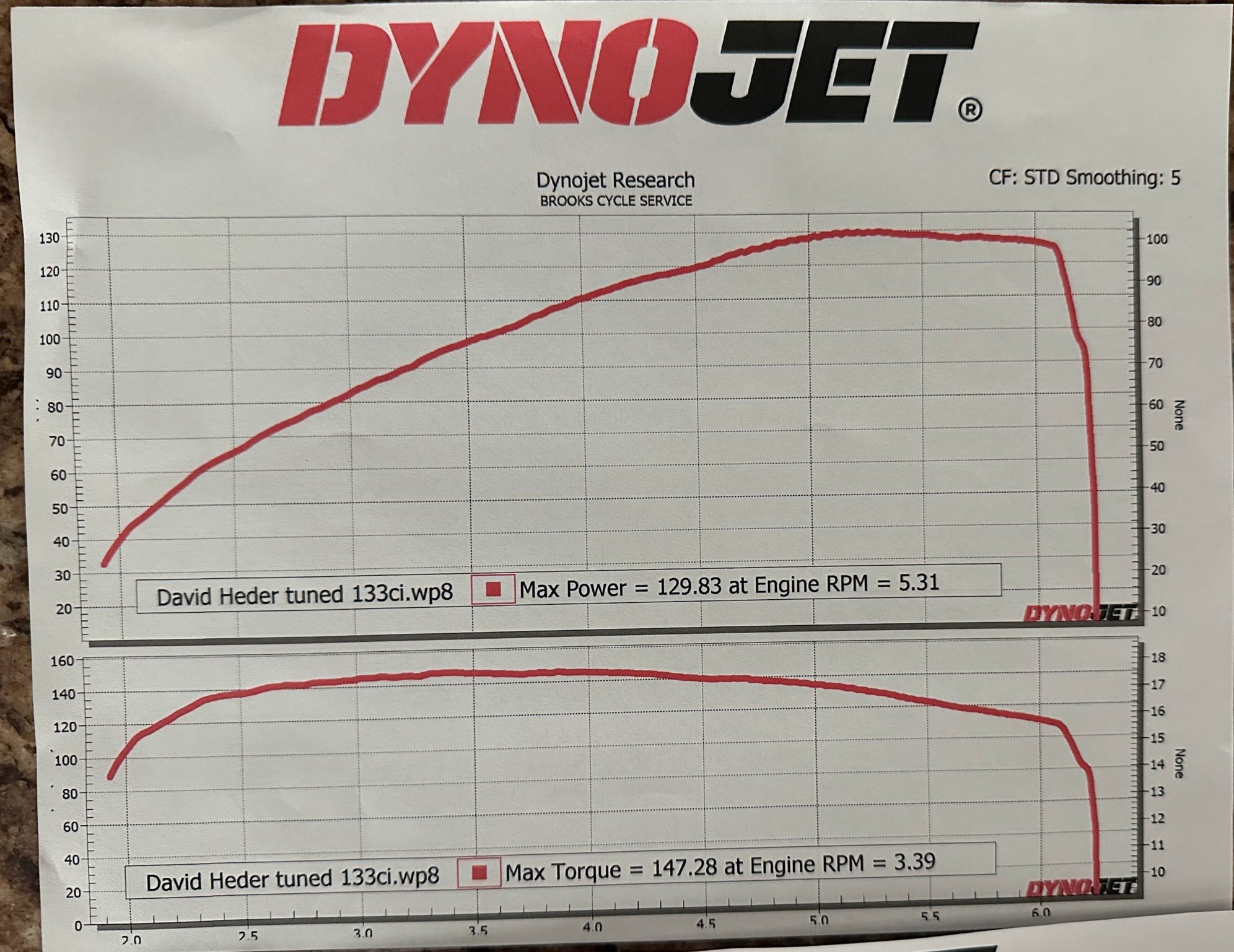

2019 Triglide FLHTCUTG
133" Tman Performance Street Fighter cylinders, heads and cam
5.5 injectors
Thunderheader
Vance and Hines mufflers
Rekluse Apex clutch setup
MotorTrike manual reverse
Speced, built, and tuned by Brooks Cycle Service in NC
