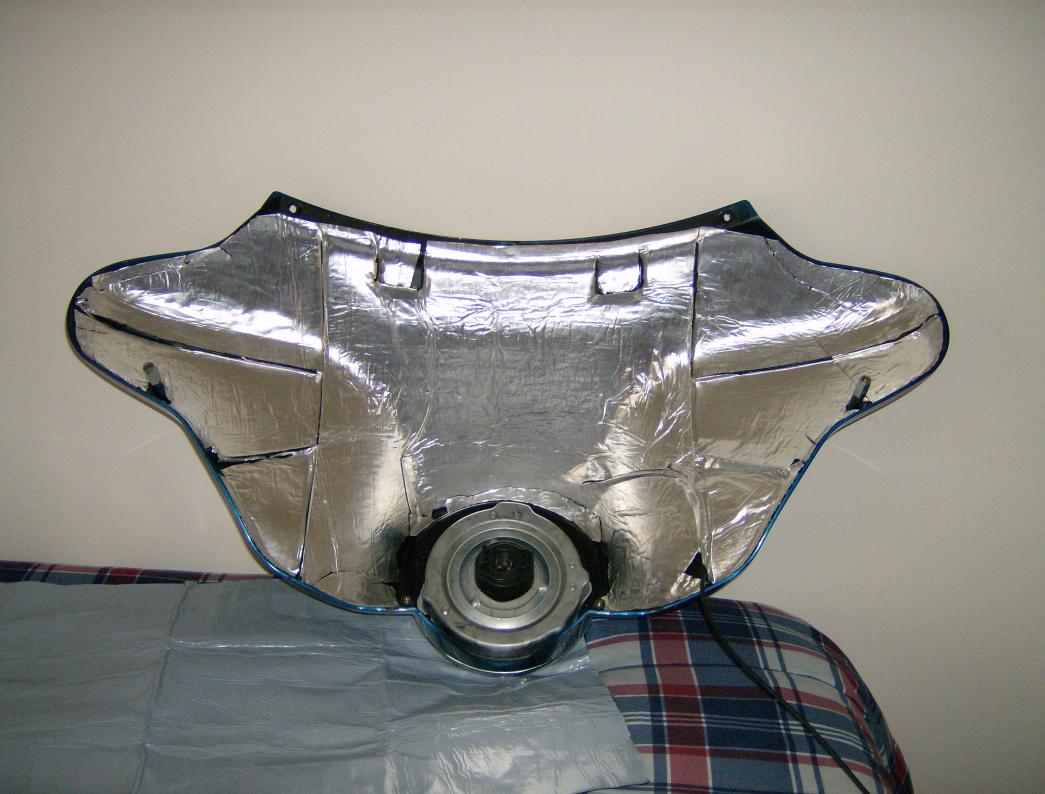

here is an idea i had to increase the bass in my 06 amp and speaker setup. i got this r blox from ebay for 38$ for 10 sq. ft. thats enough to do 2 bikes! so split it with a bud and see what a difference it makes.

as a side note this stuff is super sticky. use brown paper bag and make a template for the fairing and cut it with the backing on . if you can get a bud to hold it up while you place it it would be much easier. the rblox comes with a small roller to roll out any air bubbles. my local audio store wanted 40$ for 4 sq. ft.

just did the inside of the outer fairing. to much stuff attached to the inner fairing to even attempt it.
