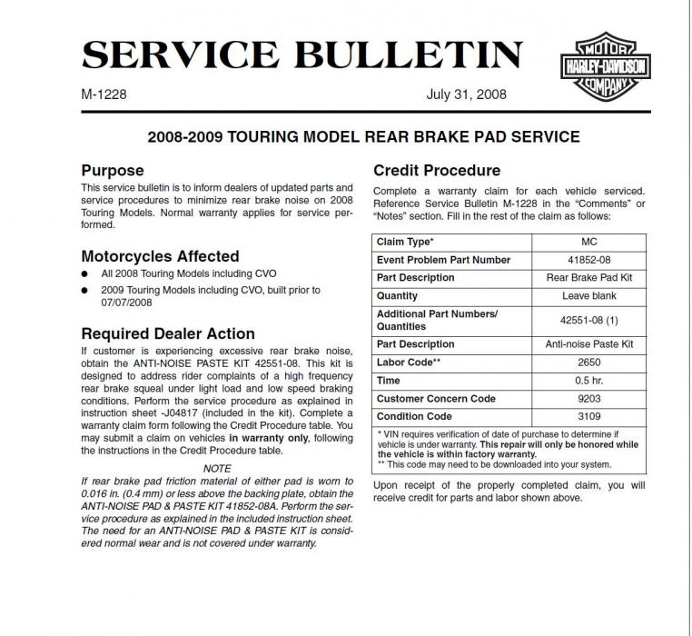

Attached is a bulletin which contains a pn# for an anti-noise paste kit

I'm aware of that problem, but this is a front brake issue. Does it also apply to the front?
