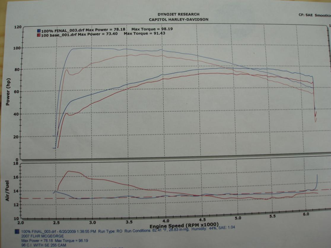

Like someone said early on in this thread, use the search function and you will find a ton of threads recently about this. I did my cam only upgrade last spring after reading a thread by Iclick about the 255's. I am very happy with the improvement over stock. We will never have a unanimous decision here, so try to sift through all the posts about cams and make an informed decision. Here is the results of my cam swap, before and after the dyno tune
