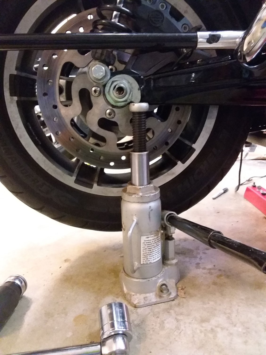

I wedge a large screwdriver under the right side (loose cam). Wedge it in between
the bottom of the cam and the floor, or lift table. This holds the cam up in place while you torque the axle nut down.
You could use a stick of wood custom cut to length too, all you need is something to hold the cam in place.
Like others said, make sure to set initial torque before adjusting the belt, if it's not torqued down initially,
it's too sloppy, and the cam will move on you.
Works for me.

I liked Ragtops method when I read it years ago, variation of the same concept. Anti seize between the nut and cam is a must. Often thought the frame side of the cam could knurled slightly to bite in and not slip while torquing.

I just updated my '96 frame with parts from an'08 RG, this cam thing had pissed me off trying to get that cam not to move.
The manual (well Haynes) reads to tighten up to 20-25 ftlbs or so before adjusting belt tension then torque, release one turn for Cush drive then retorque.
I'm going to revisit this tonight and try the wedging a piece of wood or something on the cam to help hold it and hit the 105 torque. I torqued to 100ftlbs.
