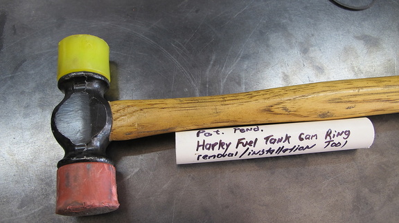

Just changed the filter and I change it ever 25k…..picture of the hand made tool on the ring…..and filter @ change.

My tool still works well - I lend it out from time to time............
