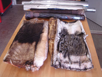

Originally Posted by paguy
My jackpots are in transit to Wisconsin. Began getting a decel pop a month or so ago. Kept adding fuel to 0 throttle and could not get decel out.
Pulled mufflers off bike and found a round rubber band like substance at front of muffler. Called Jamie who told me baffles don't breakdown. Further this substance I was seeing was a silicone adhesive that holds the packing to the side of the muffler.
My feeling is that if this sealant wears off. burns off, it will allow air to pass by the baffles and packing causeing this pop.
Mufflers sent to FM to repack.
We recieved your mufflers back and I disassembled them this morning. I do not know how many miles are on them, however they are 1 1/2 years old based on your sales invoice. The internals of both mufflers are in what I would consider in excellent, near new condition. There has actually been only a 4% loss of packing in the left muffler and 6% loss in the right based on the 500G pillow pack cartridges that we use, I actually did more damage to the packing pillow cartridges removing them from the mufflers. The silicone on the inlet nozzle is to prevent the baffle from seizing where it engages 1" into the muffler body so it can be serviced if required. Regardless, we will service the mufflers by cleaning everything up and we will replace the packing pillows. Below is a picture of the disassembled mufflers
