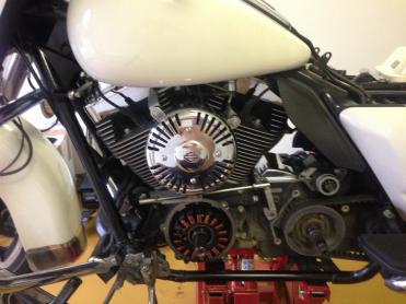

Here are the pics from final assembly and from the second assembly – after stator replaced.
Attached Thumbnails no spring compensator-p7141885.jpg   no spring compensator-p7141886.jpg   no spring compensator-p7151887.jpg   no spring compensator-img_4350.jpg   no spring compensator-img_4354.jpg

Originally Posted by bigdumbnoitall00
the bang at start up will eat your starter,it's all the low rpm torque pulses that will tweak the crank,the comp is working all the time to soften the pulses.
Just to stress it once more – this is COMPENSATING sprocket, not anything else, and it functions exactly like SE comp but being smaller and lighter.
