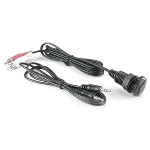

I just ordered one of these cables by Poly-Planar to play with some ideas I've got.
It may be what you're looking for.
Cheers.
