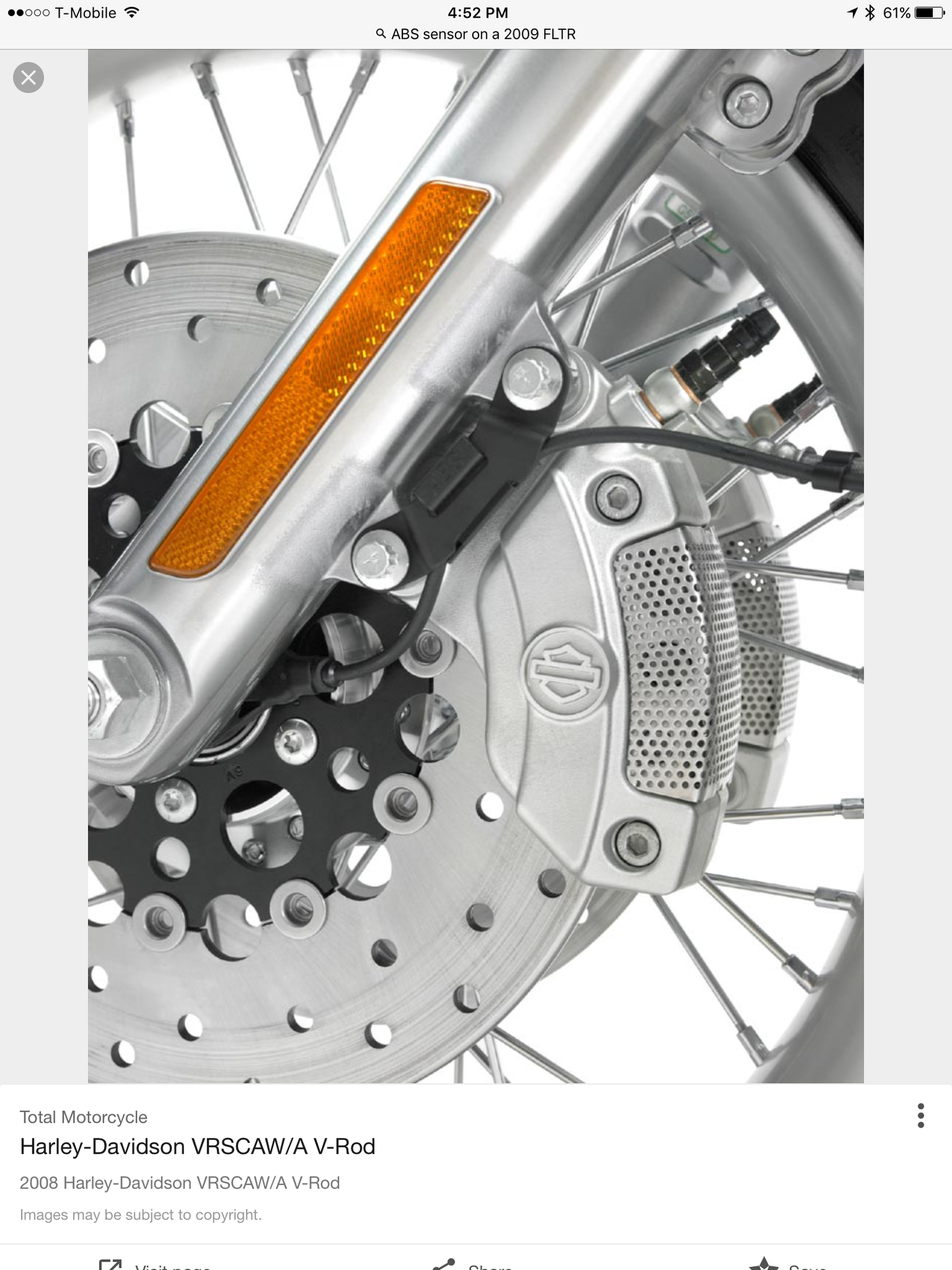

Question Can it bike still be ridden?
Broken ABS sensor on my 2009 FLTR front tire.
