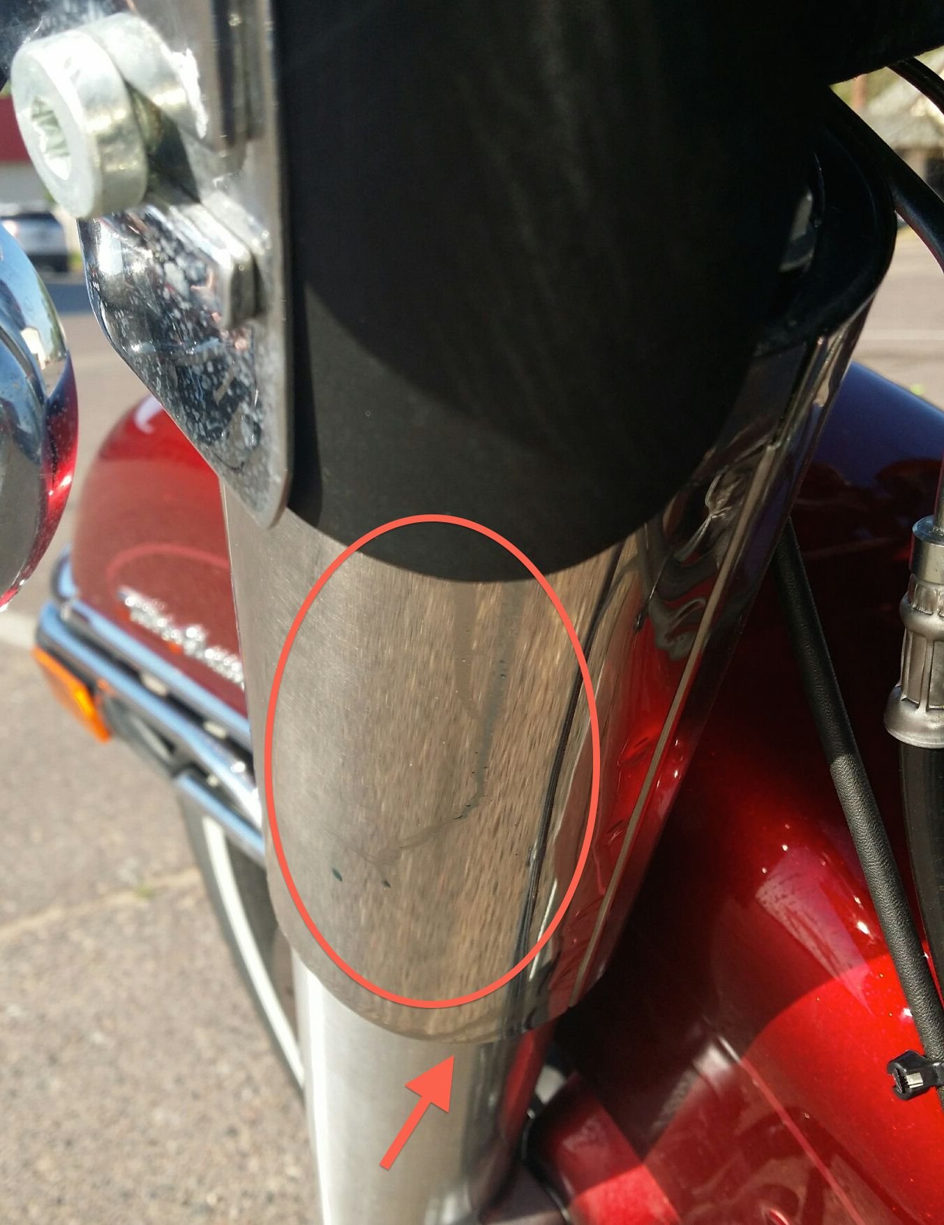

Did yours look like this? (red oval below)
I have a 2008 Ultra, only had 4900 miles when I bought it last Fall....have put on 1500 or so this year, and this has happened the past 2 rides this past Sat and Sun, never occurred before that. On Saturday, there was a single 'drip' at the location the red arrow is pointing in the picture.
I fear its the fork seal but there is no oil running down the fork anywhere, its just on the chrome fork tin as in the pic. Wondering (hoping) its not a seal.
I have greased the neck this year, and its been kinda cold till this past weekend (in MN) so wondering if somehow melted neck bearing grease is creeping over there? what path would it take I wonder?
Old May 23, 2016 | 08:36 PM
1flhtk4me's Avatar
1flhtk4me
Joined: Apr 2006
Posts: 10,675
Likes: 95
From: Billings,Mt.
I would check the fork caps,might be loose.
