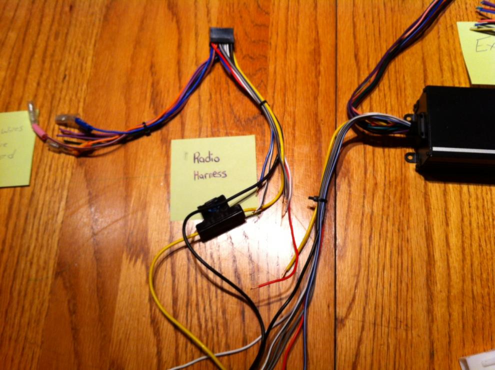

Ok so this is what I have to work with and how I think it goes together. I have been so confused because I believe this unit has had the factory ends cut off. This leaves me with just the wires to work with, hey it was free what more can I ask for. Anyway this is what I have.
Todays accomplishments:
1. Alpine IDA-X305S has been installed.
2. 6.5 inch Focal speakers installed.
3. I think the wiring figured out.
As you can see in the pictures, I have the factory (black) harness being connected to the wires on the left side of the Alpine power pack. The wires that are not being used for both the radio and amp are zip tied and are off to the side.
Next I have the Biketronics (white) harness being connected to the wires that are coming from the right side of the amp. Again the extra wires that are not being used are zip tied and off to the side.
I believe this setup is correct but will wait on connecting everything until this is confirmed.
I wish I had the money for a Rockford amp and this might have been a lot easier. Anyone know someone looking to sell one?
Anyway thanks for everyones help, You all are great!
Joe

I'm pretty sure you have it backwards. I had to go digging around to find mine. If you look at the picture of mine, this is how the amp should have looked when you bought it. I'm sure the ends were cut off because someone didn't hook it up to an Alpine head unit. Anyway, the wires on the left (in my pic) should plug directly into the head unit. The wires on the right should plug directly into the original plug that came with the head unit which would then go to the speakers or factory harness connection. You can always stop into a stereo store and I'm sure they would help you out with it.
