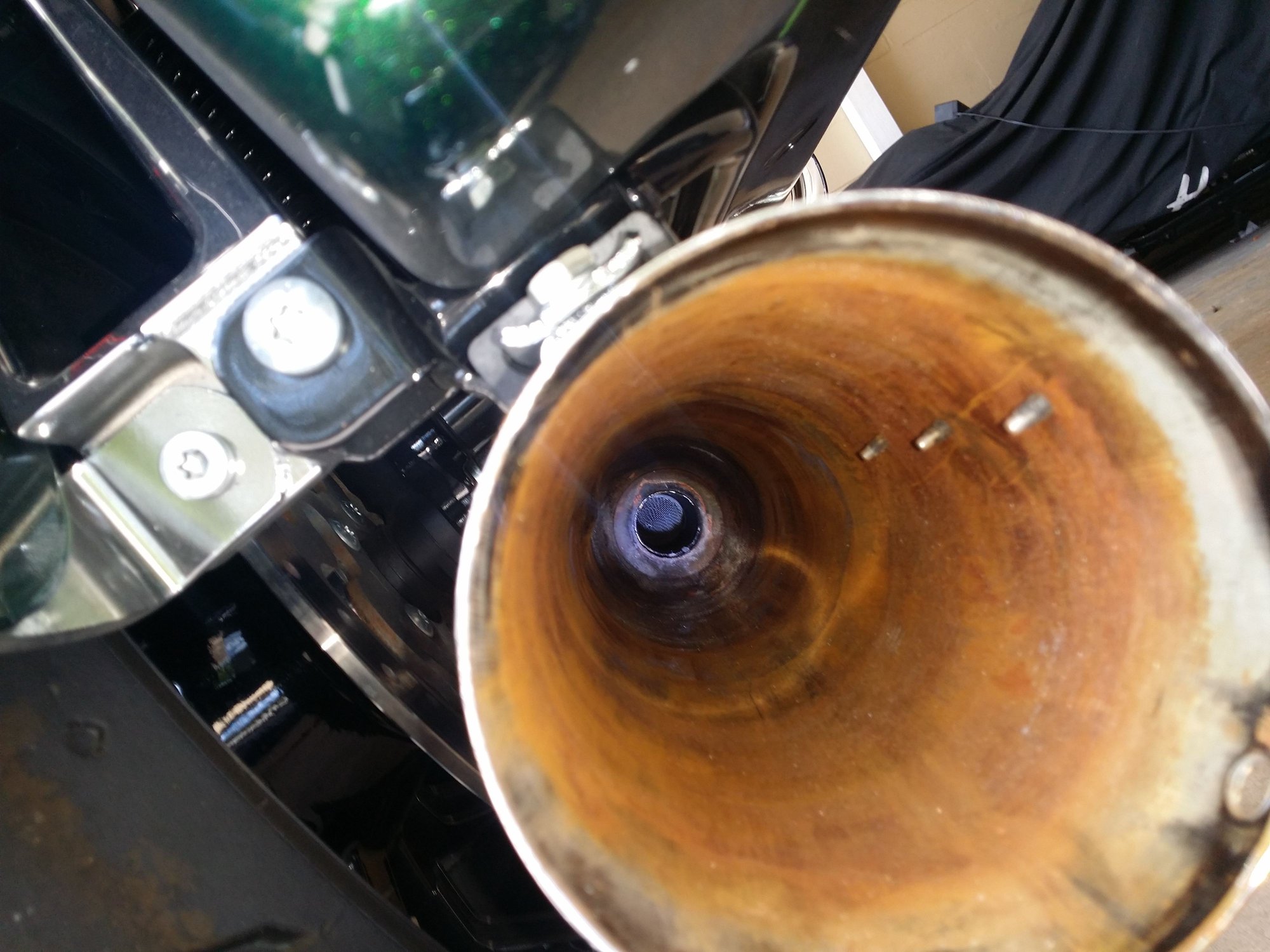

anyone figured out how to pop the script off the sides? its not just glued on..but be pinned or something.
Old Mar 18, 2015 | 12:09 PM
  #34
Cool Inferno's Avatar
Cool Inferno
Joined: Dec 2014
Posts: 1,036
Likes: 45
From: Florida
They have three pins each. You may have to remove the baffles in order to reach the parts holding the pins if you don't want to break the emblem.

Sorry no I didn't. Kinda kicked myself in the butt for not taking any pix of the baffles after I put it back together. The main reason I took some photos was because I was trying to find out why the baffles were being forced out to the rear. In this photo you can see how far the exhaust header protrudes into the pipe when fully inserted. The marks on the exhaust header end shows where it was making contact with the baffle. That was discussed in another thread here.
Is the baffle wrapped?
Yes it is
Yes as Book-it said and pretty thick. Had to use a long screwdriver to push the wrap away from the emblem pins in order to slide the baffle out. Had to do the same thing to get the baffle back in.
Thanks - was hoping it wasn't and adding some might improved the pooh sounds if that cat is removed.
