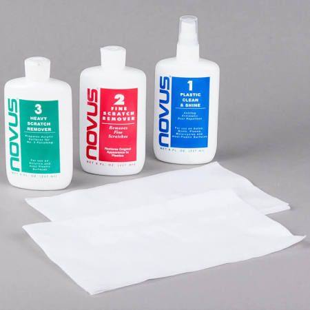

I may be new to Harleys but I will second the motipn on usong novus products. Ive been using them for years polishing clear styrene to look lile glass. The stuff is amazing.

I used this product in the past.
