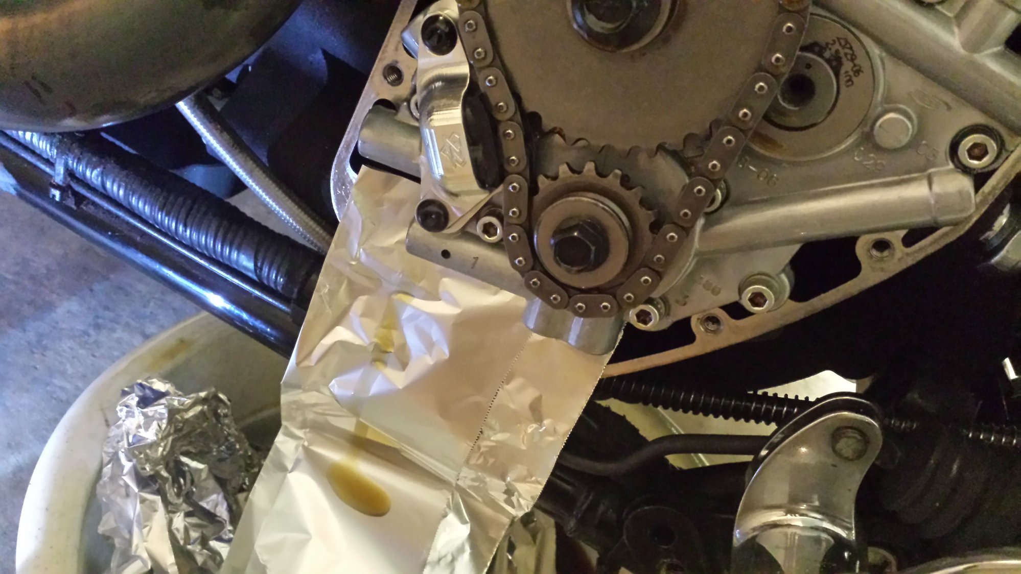

Originally Posted by Boyer8
You can get the spring and piston out without pulling the cam plate?
Yes you can. That part of the CAM plate is elevated out. Just be careful when punching out the pin. As you can see I used tin foil just in case.
Thanks for the info!!!
My oil psi is running about 10-12 psi higher then normal. Tried the sending and that didn’t fix it. Everything I’ve been reading is the pressure relief is stuck. I didn’t want to get into pulling the cam plate. This is awesome news.
Thanks again
