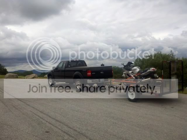

Forged (yes forged!) eye hooks into metal, bike in Neutral, 6 high quality ratcheting straps, CONDOR wheel chock ( got a pingle not impressed) compress the suspension a bit, but don't bottom it out, leave some room for it to travel or you will blow seals
DISCONNECT AND REMOVE THE BATTERY... nothing worse than seeing a bike in flames tied down to a trailer, and I have seen it happen.
I have trailered my 4 bikes thousands of miles without an issue, don't go cheap

the bike is going to bounce, I want mine to bounce, the key is to compress the suspension so the bike is secure, yet the suspension will soak up the bumps and keeps fairing brackets, etc from breaking.
If you tie the bike down properly, and there is suspension travel, the straps will not come loose.
I love my Condor chock, on short hauls I will only use 4 straps with it, and that chock will hole the bike in place, you would have to roll the trailer to get it to come off of the chock
PS the weakest part of any trailer is the bearings, repack them yearly and you will not get stranded
