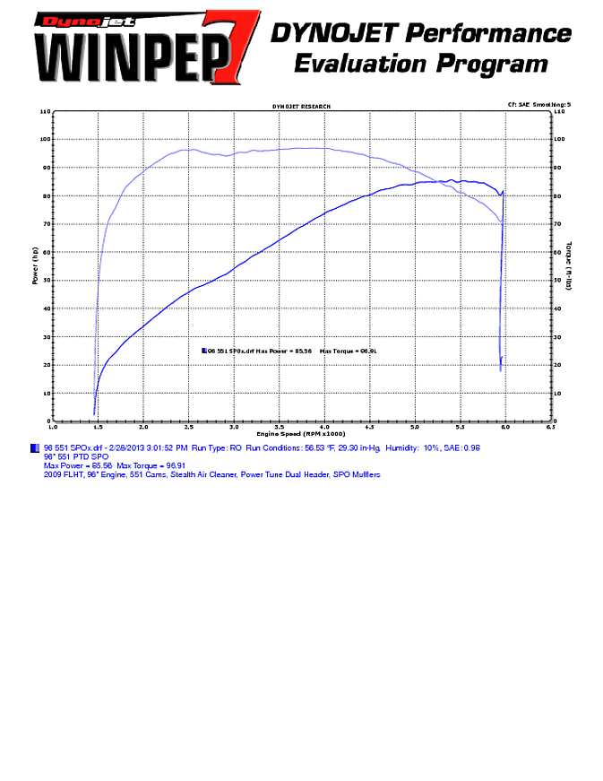

Try the S&S 551. Torque dow low. Dyno with header, mufflers, air cleaner, cams, tuner.

I also like the S&S 551 easy start great for hot starts you don't need compression release it's build in the cam. 103ci 10.1 flat top, head work large valve, headers and programer make good power. did i say easy to start when hot.
