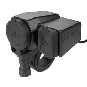

Fwiw, I've got one of these on my handlebars. Like it well enough that I'll get a few more for other bikes, and the other side of the handlebars.
Foxtrapper, Do you have a link for this?
I got mine from one of the vendors on e-bay. Just search "usb cigarette lighter handlebar". Seems like they are all the same, just buck or two difference in price from the various sellers.
Bunch of them on Amazon as well. Same search "usb cigarette lighter handlebar".

yellotang, i actually have one of these mounted on my BMW for my cell phone... None on my limited yet... the problem your going to have with this charging port is that between the two ports, there is only 2.1 amp available to charge your devices... fine for a cell phone, but for charging a tablet or a camera, its probably not going to work.. check the requirements for the actual chargers for those devices... I know it won't charge my tablet or my camera, just not enough amps... what your probably going to need, is a inverter to convert DC to AC, and use the devices actual charger, at least for everything but your phones. I do a fair amount of dry camping with out power while traveling on my BMW GS, and have a set up to deal with just this stuff.
I have a second battery ( a lithium ion motorcycle battery ), that i have connected to the bike with an battery isolator... battery charges during day while riding, at night i connect a DC inverter to it, and use it for charging my devices, and powering a medical device i need to sleep. i'm in process of setting it up on my limited, for a 8 day road trip this june that i will be using to camp most nights with out power.
