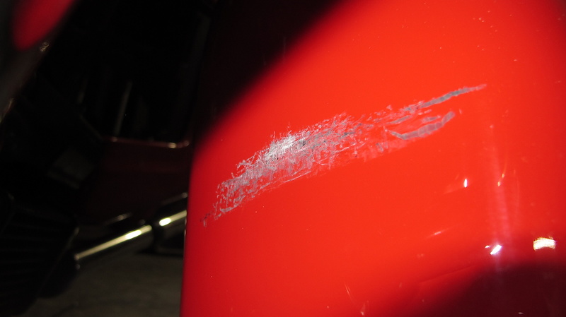

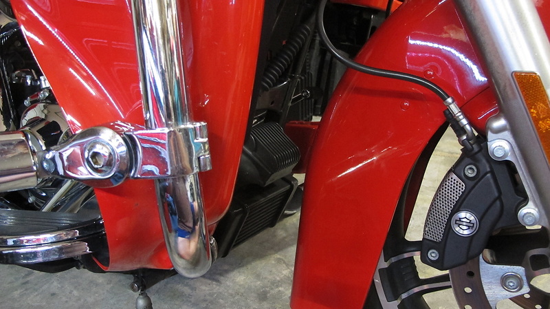

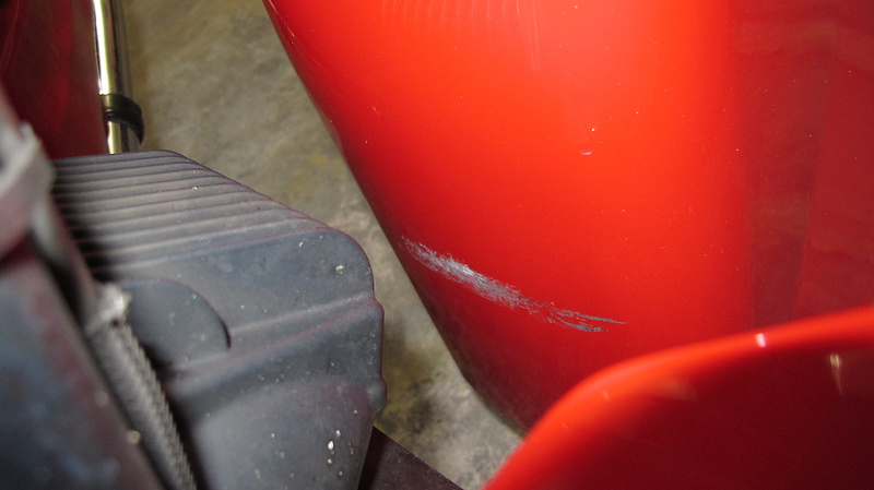

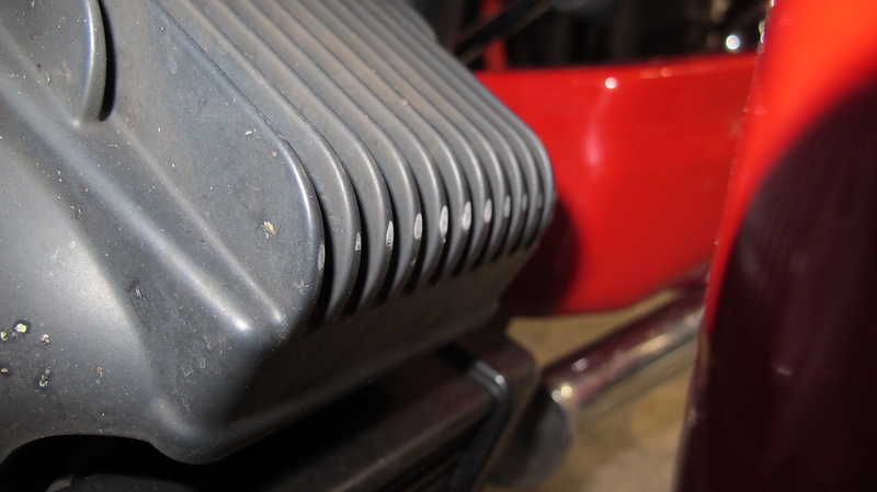

I have the Jagg 10-Row Fan assisted oil cooler installed and noticed lately that it has started to hit the back side of the front fender.
I don't recall this happening when I first installed it and it seems to have been hitting only in the last 10K or 15K miles or so. I noticed awhile back but thought it was just dirt/mud and it would wash off... well it didn't.
The "problem" really appeared this last week when I started having some handling problems under aggressive braking while turning. It turns out that my front shocks are in desperate need of a rebuild and I noticed that during aggressive braking the bike started to fight me. This was partially due to the front end needing to be rebuilt and partially because the the front end was diving more than it had in the past and it was hitting the voltage regulator.
My opinion, if you run this setup you need to stay on top of the maintenance in regards to the front fork tubes.
Pics below...

Sure looks like the voltage regulator making contact, not the oil cooler. While you may need routine service on your forks, I doubt the bushings wore out so bad in 15K to allow enough front to back motion to make contact. You can loosen the VR and fender bolts and cheat them in a favorable direction by taking the slop out of the hardware. If that's not enough, you can oval the VR mount holes with a round file. I did these things and a lot more when fitting a fan to my oil cooler. In the end I had less than an 1/8" clearance through the full range of motion of suspension, all it has to do is clear, doesn't need to be a lot.

Yes it's the Voltage Regulator hitting the fender and not the oil cooler.
I have already talked to the dealer before I posted my message and we both agree that contact is only being made when the forks are at or near full compression but neither of us feel that the tubes are loose in the triple trees... though there may be some play if the bushings and seals are shot.
In talking to the dealer, it's obvious the front forks need to be rebuilt and since this is normally done at the 100K service and since I am sitting at 95K... they will just perform the service now. I believe that the normal service interval for the shocks are every 50K miles which was when mine was done last.
This is on the heels of last weeks problem, where I just replaced the fuel filter housing because it was cracked and I lost fuel pressure. Unfortunately the recall of 2008 did not apply to my 2010 bike.
