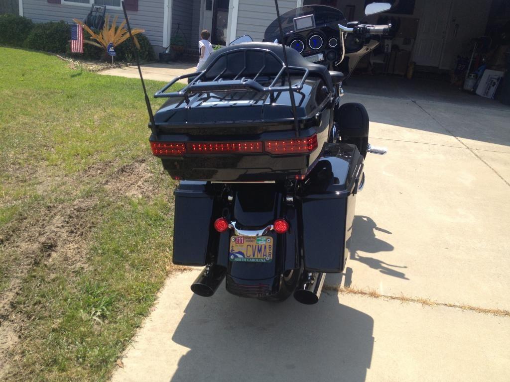

I added a tour pack and was looking to wire in the lights, tucked under my left side panel I found a harness that was for the tour pack lights.

Harley sells an ultra harness, not sure about road kings or your year though?
If you have an after market head unit in your fairing you could just run speaker wires from the radio back under the tank and make both end quick detach if you still remove your fairing?
On road glides and street glides the wires for the tour pack lights are under the panel were the fuse block is, zip tied behind it.
I'm not sure how big of a hole your stock tour pack lights will have after you remove them but I use the cheap eBay style CVO LED tail lights and they have been flawless for years. They are brighter than the 2013 an older harley style CVO lights but not as bright as the stock 2014 ultra lights. I also used tinted Ebay LED side marker lights and not one LED burnt out.
