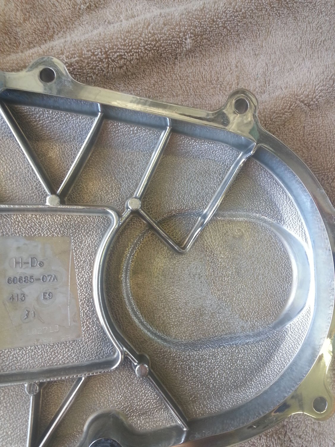

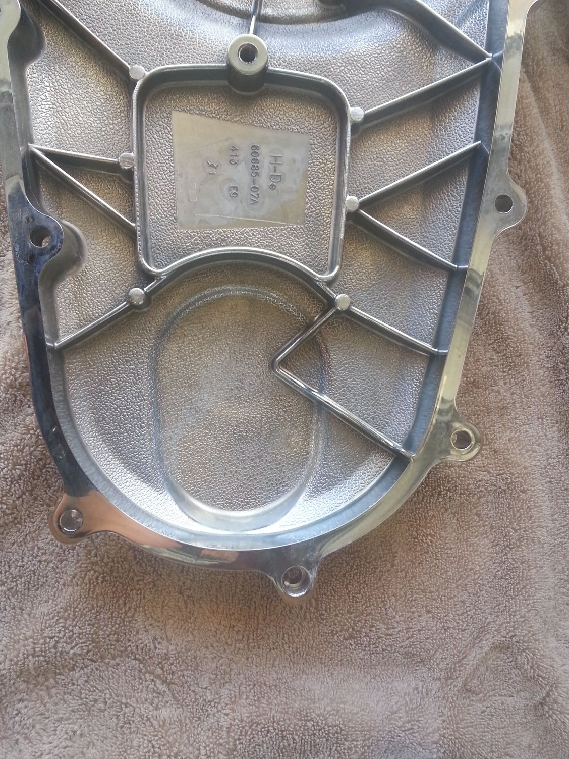

2014 touring primary with new compensator cast
2014 touring primary with new compensator cast-2
fyi I changed my compensator on my 2011 flhx and was not happy at all with gluing in that plastic part, and was going to eventually get a used 2014 take off primary where it was added to the cast. Instead I got the new 2014 and just removed the primary for powder coating and took a couple pictures of the newly casted cover.

I glued in the plastic funnel, as per instructions, on my bike without a problem. I used the glue from Harley, which is nothing but Maxlok MX/T6 which is available commercially. When it dries it is as hard as a rock, harder than the plastic and as hard as the aluminum. It ain't going nowhere as long as you follow the instructions and put the glue on as pictured in the instructions, use a clamp on it for a few hours and had cleaned surfaces going in. The funnel does not touch the compensator and is under virtually no pressure so there is no danger of it breaking off. That part is a non issue except in **** retentive personalities. Why anyone would install the '14 comp without the funnel or proper cover is completely beyond me, unless they like a galled and scored compensator hub.
What is an issue is I do get a small clunk on cold start and you can hear some low rattling until warm from the primary. I stopped worrying about it and ride. I don't get any banging if I accidentally lug it and its fine hot.
