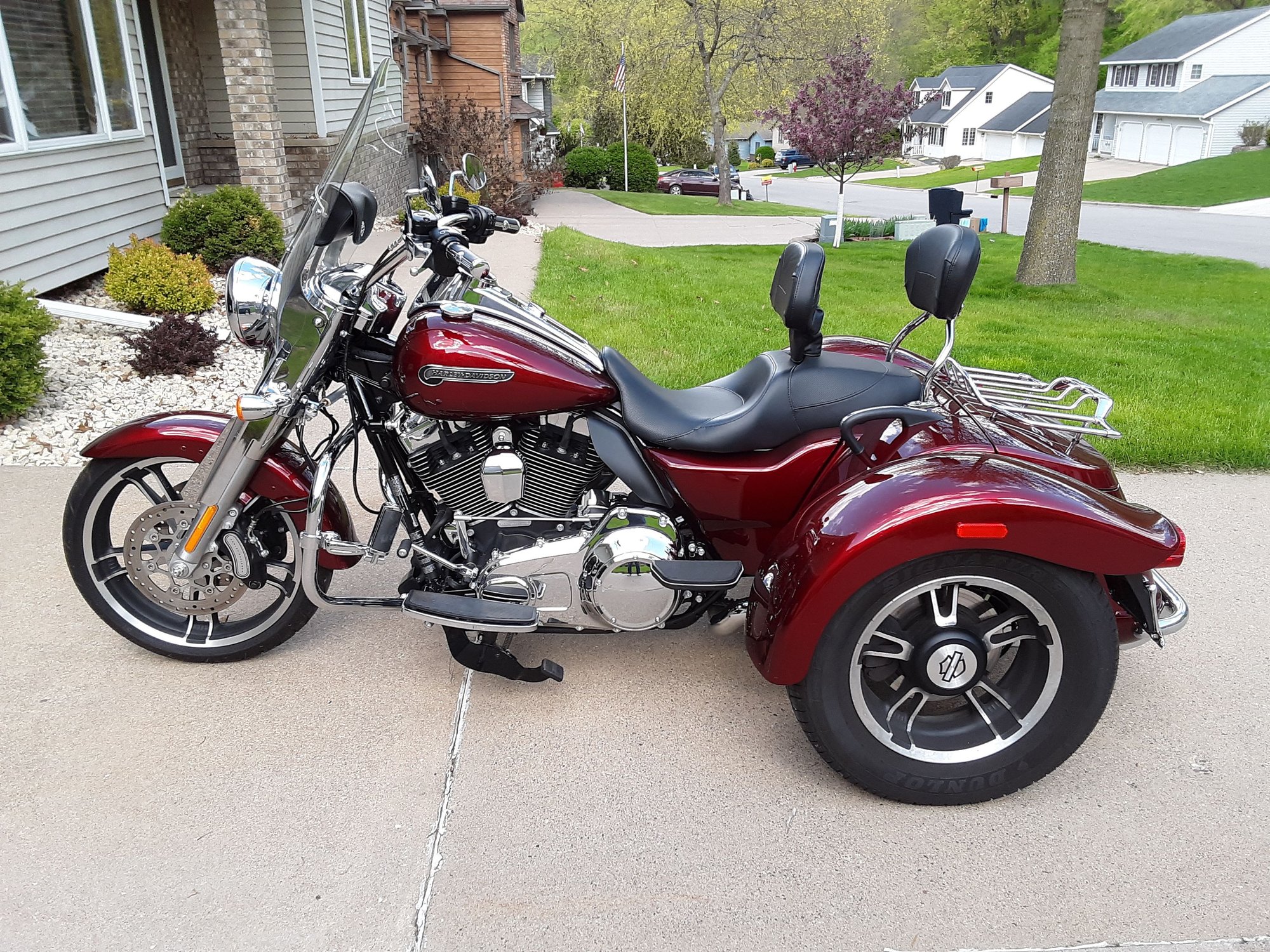

Since washing my 2016 Freewheeler earlier this summer I have been having problems with the glass fogging up on the inside of the speedometer. It is crystal clear when it is sitting in the garage but when I get out to ride it fogs up. Is there a way to resolve this?
