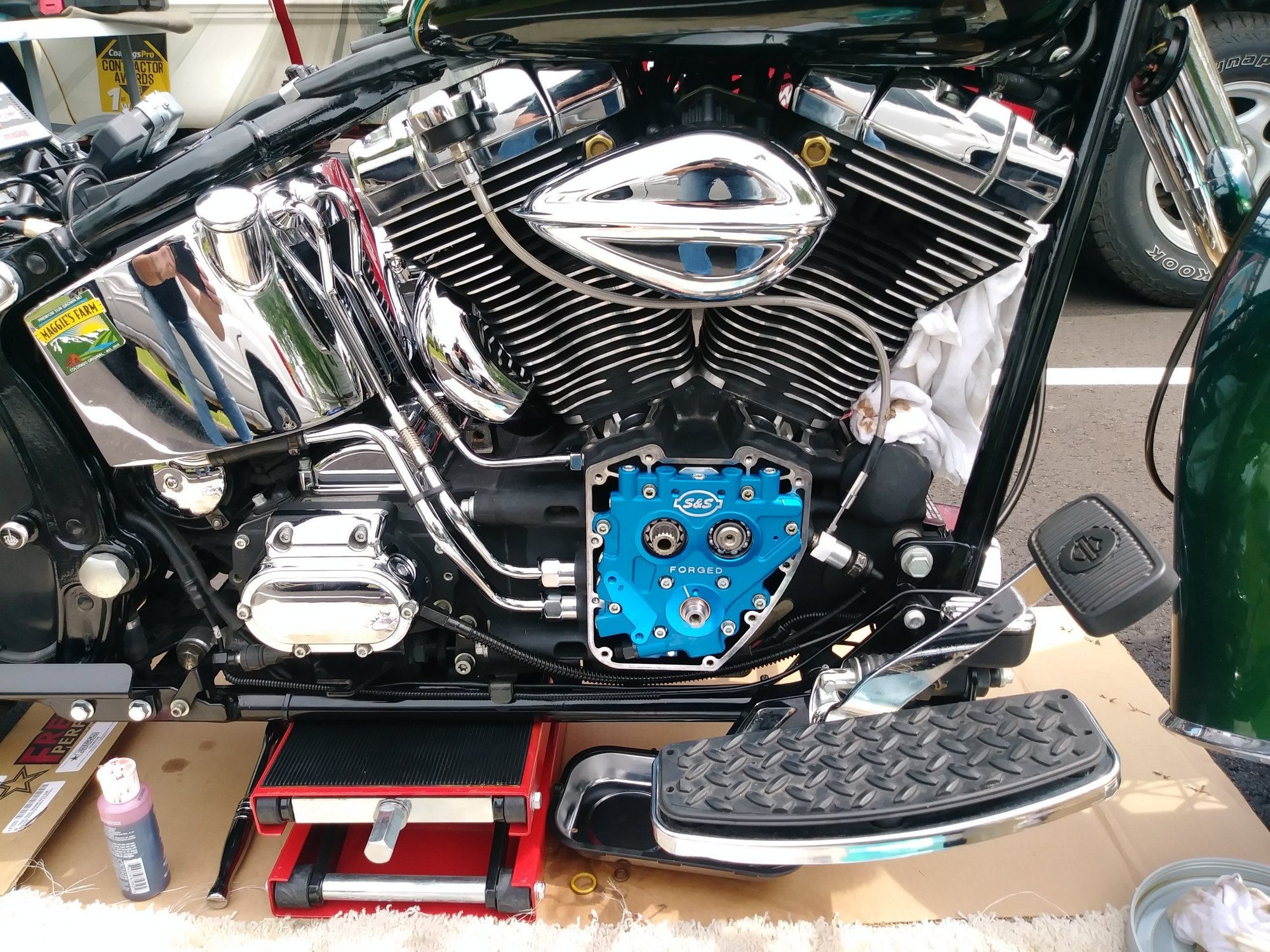

No fancy anodized cam plate, or pump needed whatsoever.
Doing the 2nd Andrews 21 set-up this week, today.
One chain drive, the other a gear-drive on a Magnetti-Marrelli Police model.
Our clients love how they run, once tuned.
Scott

509 cams and "fancy anodized cam plate"

We have the pretty blue ones, and the plain billet aluminum ones on the shelf, and in stock, for those that want 'em.
Make no mistake, OEM pumps and plates are absolutely fine.
