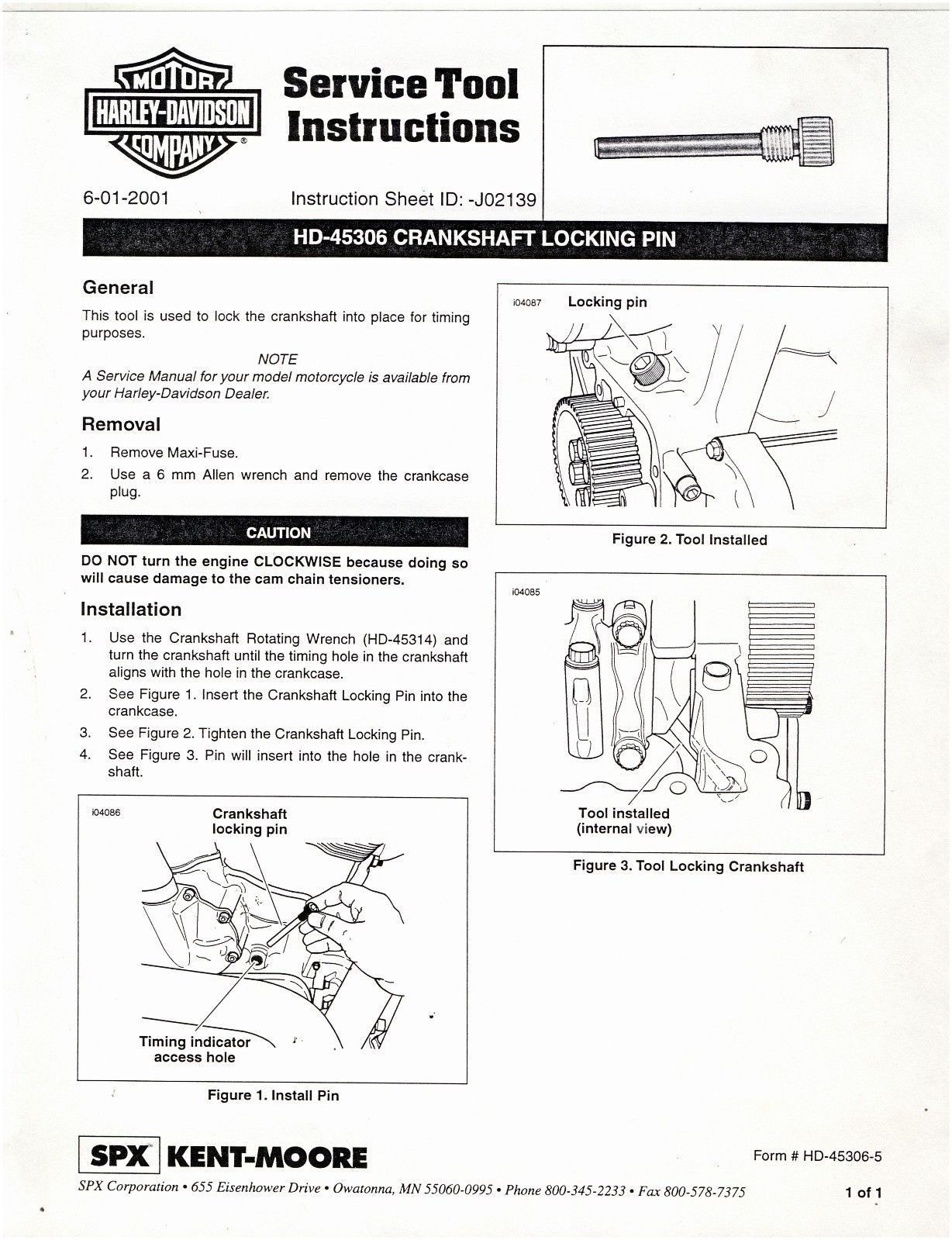

Old Jul 13, 2020 | 02:15 PM
Hal64hd's Avatar
Hal64hd
Joined: Feb 2007
Posts: 1,161
Likes: 39
From: LOST WAGES
The best thing is to get a factory manual. There is no 6th gear in the VRSC platform.
The 2 bolt cover on the stator side is removable and has access to the crankshaft. DO NOT ROTATE ENGINE BACKWARDS IT WILL CAUSE CAM TIMING TO JUMP AND CAUSE ENGINE DAMAGE
Then get either a 8mm or 5/16 drill bit to use for the TDC locking tool inserted between cylinder heads on right side after removing the TDC plug

Old Jul 17, 2020 | 01:25 PM
Hal64hd's Avatar
Hal64hd
Joined: Feb 2007
Posts: 1,161
Likes: 39
From: LOST WAGES
BTW you cannot do a leakdown at TDC on a 02-07 due to compression release cams hold the exhaust valves open. There is a specific procedure to do a leakdown on a 1130cc. Also the Compression Test on a 1130 is going to be about 100psi or so different between front and rear cylinders Front is always low.
Explained in the manual
