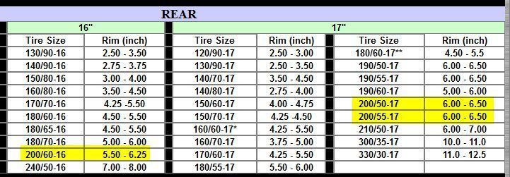

Hi guys, I am wanting build a rim to run a 200 back tyre on my bike. I have the option of getting a 5.5 or 6 inch rim but the 6 is a lot more expensive (as in $150 more)
My question is will the extra 1/2 inch make any difference to how the 200 looks on the bike or affect handling etc? Will the 5.5 pinch the tyre compared to the 6 inch?
Any advice you guys can give would be great.
Thanks!

What does the Tire of choice manufacturer recommend?
http://hdwheels.com/Product.htm
