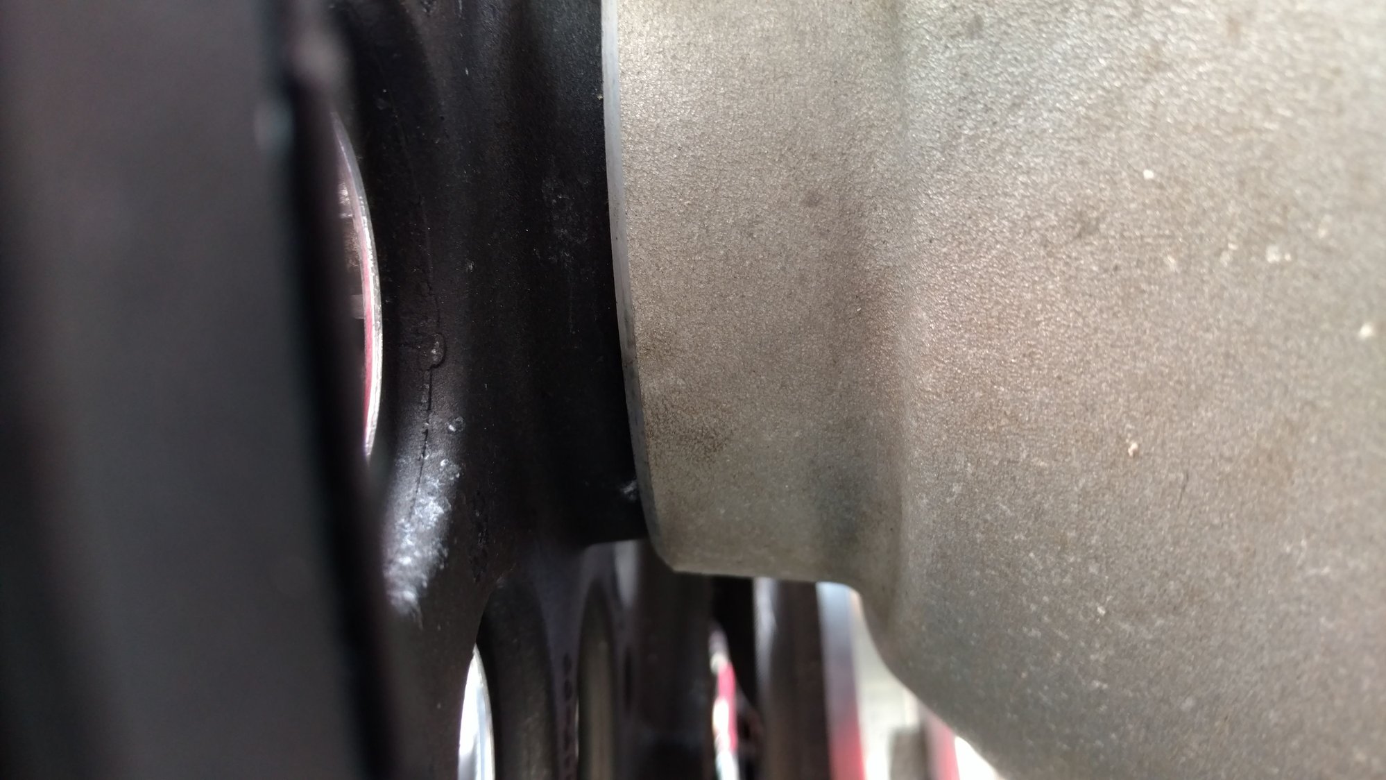

Take a good pic showing the hub right where it meets the brake rotor.
(this is for wheel identification purposes)

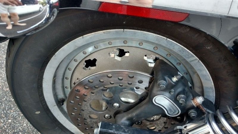

Here's the rotor and pulley side.

I originally was thinking you had a 03-06 softail wheel which would cause the symptons you describe, but after seeing your wheel in the pic I posted and then your following confirming pics, that doesn't seem to be the case.

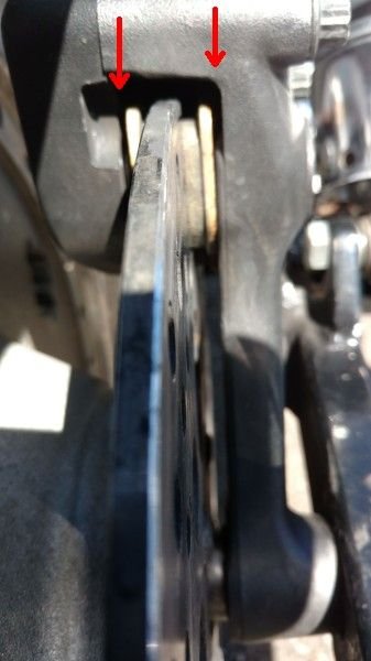

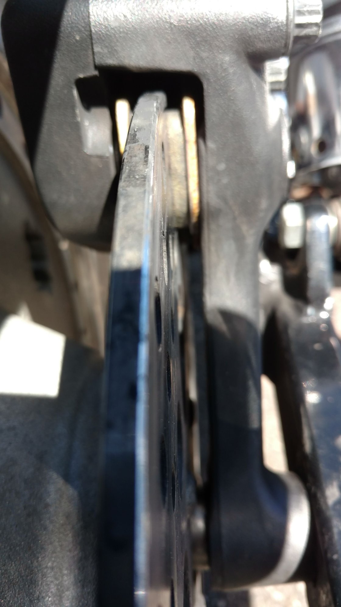

How bout a good pic showing how centered the brake rotor is within the caliper
Does it look centered to you?

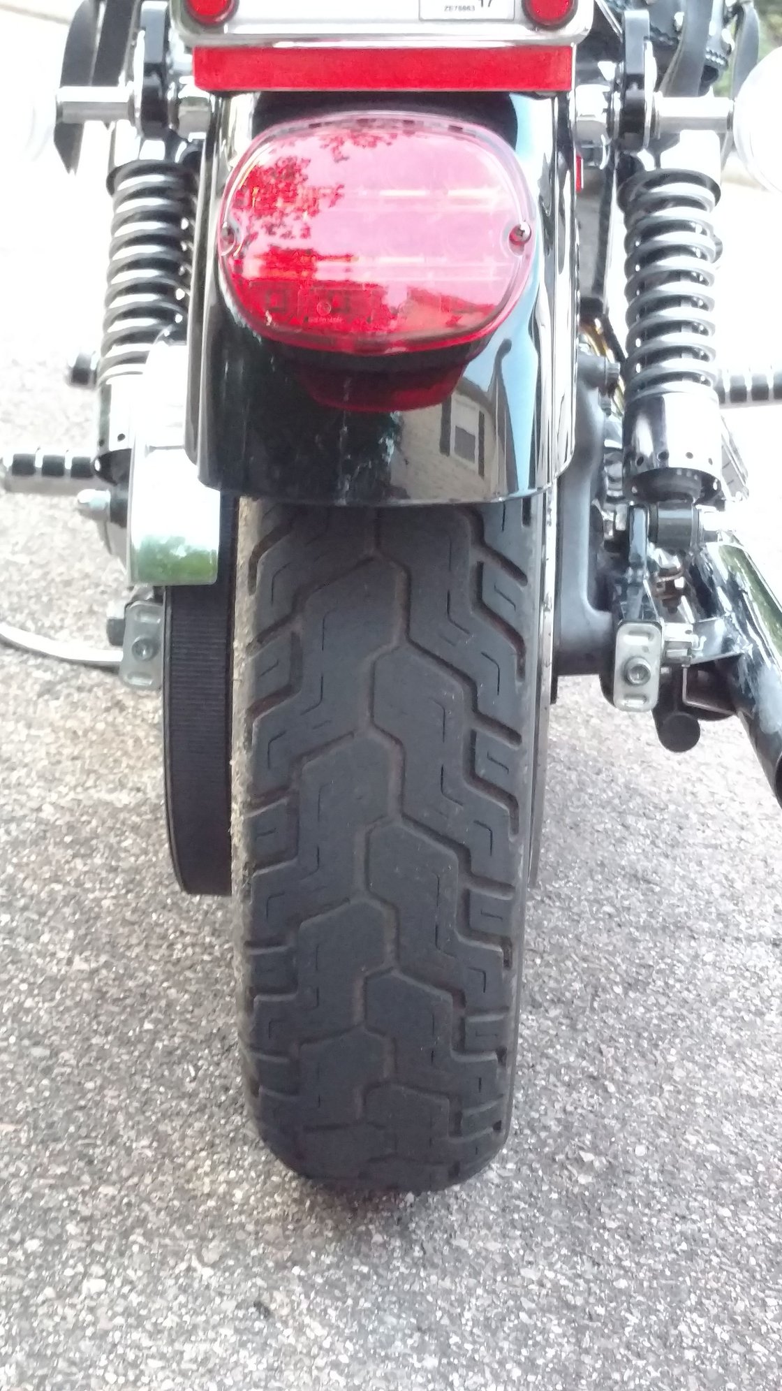

Not sure if this is what you were talking about? I went on a ride after the rain here, found some nice dry wet spots and rode through to check my tracking. It was straight?

Hard for me to see from where I sit...Does it looked centered?
Use your pistons as a reference
