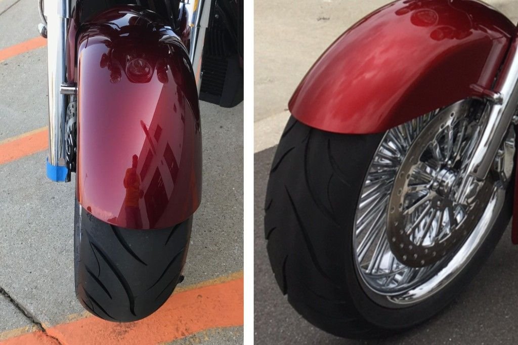

Decided to go bigger.....rode it for about 30 miles tonight....bit more cushion....but a hell of alot more confidence...
I wanted o keep the same "motif" as the old rim as I will not change the rear rim...

Great...
As a side note, when using a Rear tire on the Front, it is usually recommended to reverse the Rotation...unlike yours
http://www.avon-tyres.co.uk/motorcycle/faqs

I saw that and I actually asked the folks at the HD dealership.....they said it was OK....i also saw the orientation on another bike ... I think it will be ok.

His (on Right) looks to be reversed...different than yours

It does doesn't it...my mistake.....BUT....
I wonder how his will fare when it rains and the water is channeled toward the middle of the tire, will he hydroplane .....versus the way I have mine set up.....just thinking out loud.

Check the directional arrows on your sidewalls! Your arrows should point in the opposite direction to the way your front wheel actually rotates.

It's really this simple...
AVON is in the Motorcycle Tire Manufacturing Business. If I buy an AVON Rear Tire and they say to reverse the Direction when using in the Front, then I think that's what I would do
FWIW...
"the folks at the HD dealership.....they said it was OK"...
Wouldn't give me a "Warm and Fuzzy" feeling
Maybe this will help the next guy

Not to sound like an idiot, but what's up with the blue painter's tape?
It was there to hold on and cure a a two sided tape that is holding a piece of chrome on the legs.
