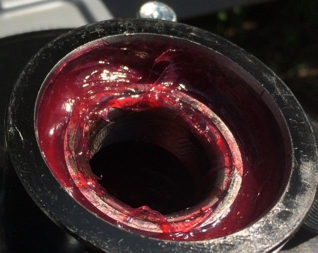

I've seen dozens of bearings that were dry and cooked inside from lack of grease. That's why I never install a bearing without popping a seal and checking the grease. If that thin string of grease on one side is there, I always clean that off and use a quality synthetic, enough to pack the ***** in the ball cage, but not filling up the space between the cage and the seals - on spin up, the excess grease is slung off the ball and cage assembly into the space between cage and ball leaving a minimal friction tunnel for the ***** and reservoir of grease against the seals - which will be needed as time goes on. Engineers - I've talked with some that agreed, and some that said if they learned it in school, that's the correct way, but they seldom see the destroyed bearings we mechanics have.
The grease itself is a major issue, and even airlines and aircraft manufacturers can get it wrong; I got the grease type changed a few times while working for an airline, after pointing out the reason components were failing was due to the wrong grease, not improper assembly or use. An example of what I consider a grease problem today is the Chevron Starplex grease often used as OEM in trailer bearings. It's hygroscopic, meaning it absorbs moisture. You can even see it, it's a dark red grease that turns pink as it absorbs moisture. There's actually a reasoning behind this for some applications, it prevents water droplets sitting in one spot and causing a rust spot, but it also has to be purged and re-greased frequently or when it gets saturated, it rusts everywhere. And how many trailer owners do that on a regular basis? I bought a trailer last year, and knowing this, pulled the bearings before using it. What do you see in this photo?
Notice the brown line in the grease? The roller cage was getting surface rust on the inside.
Cleaned up and re-greased, this is the color it was supposed to be, actually Mobil 1, but it's the same color as Starplex. Starplex is a good grease, but you can't let it get wet too long. This trailer had only been on the road from store to my house, too, no water exposure other than sitting outside in the store lot. This looks heavy on the grease, and it is, but this isn't sealed on the inside, and excess grease is slung into the interior hub cavity, you can't really over grease it. On a motorcycle wheel bearing, I don't cover up the ball cage, enough gets caught between the bearing bulges. And if you ever run into a wheel bearing almost filled with plastic spacers instead of metal ball cages, I'd advise throwing them away. I've seen them full of plastic grit worn off by the *****, plastic makes a poor lubricant. I bought a new wheel once that came with that kind of bearing, just threw them out with zero miles.
I've seen enough manufacturing shortcuts and downright poor engineering to not have blind faith they're always going to do the right thing. Throw low cost Chinese factories into the mix, and take your chances, I don't. I even replaced the Chinese tires on my trailer with American made, and I'd never think of using Chinese rubber on a motorcycle. Same for bearings, with the possible exception of AllBalls, that seems to get good quality control, probably enforced by the American company having them made, not the Chinese factory.
