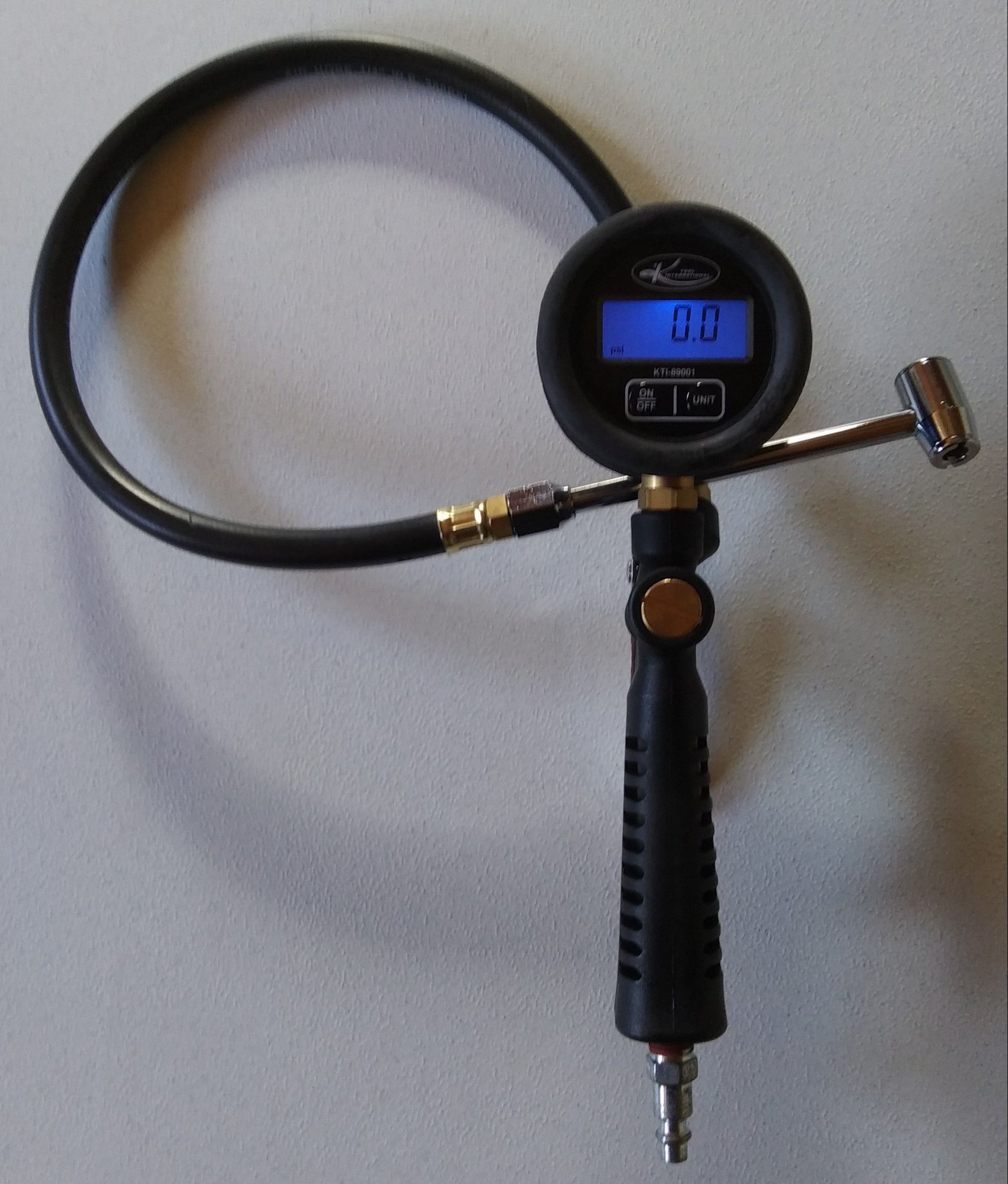

Those wheels have valve stems on the rim centerline ... so No
The reason that the valve stem is in the centerline of the wheel these days is the factory found out that nobody makes an inflator or tire gauge that is angled 90 degrees, and they knew it would **** us all off...
Old Feb 14, 2020 | 05:06 PM
barneyboy's Avatar
barneyboy
Joined: Dec 2017
Posts: 5,076
Likes: 3,293
From: Plover, WI
Say what? Here's mine. 90°
