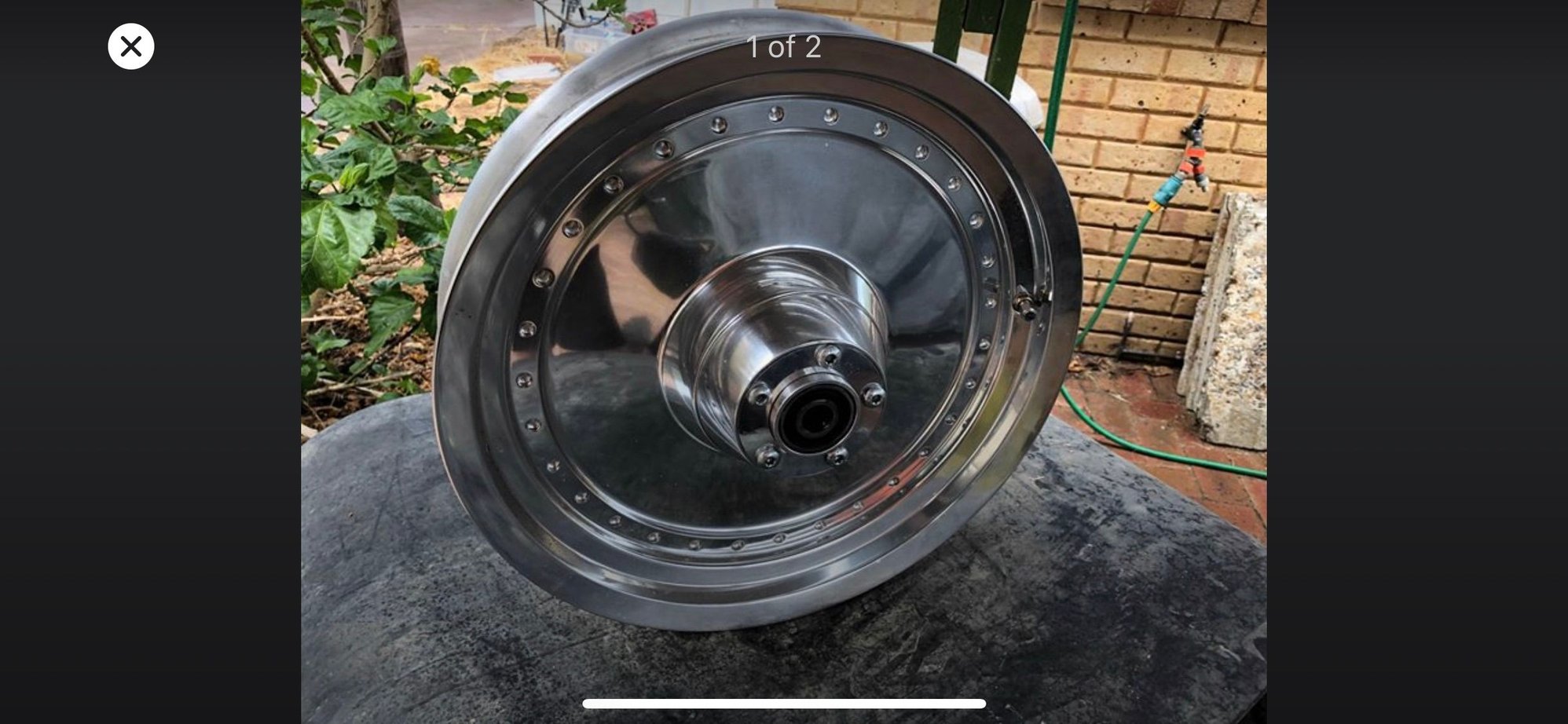

Hey all, just wondering if a 16 x 3.5 chrome solid wheel would fit onto a 2005 FXD SUPER GLIDE. I HAVE NO IDEA WHAT MODEL ITS off.

That's a 16x3 Front Wheel ... is that what you wanted?
In either case (for front or rear) ... NO sorry

I was told it’s a 16 x 3.5 by the seller, and I wanted it for the rear. Would there be a part number on it ?

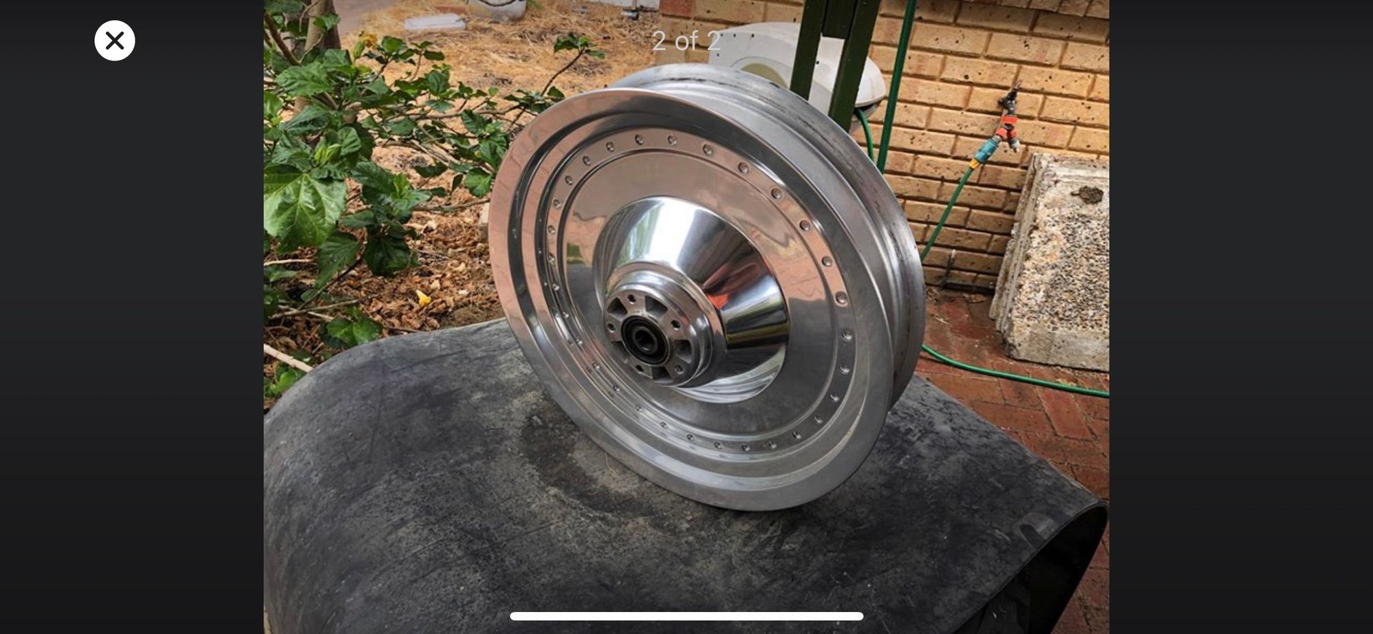

That's the problem with some "sellers" ... they don't know enough about the parts they are selling
The 3" is measured from the inside of the Rim "Lips", but a lot of people will measure to the outside in error.
No, most wheels don't have a part# on the wheel, that's why it's helpful to know the nuances of wheel identification.
That wheel has many tell tell signs of being a Front, but again you need to know the nuances.
But there is one obvious sign that some would think at least that it might be a Front without knowing much more ... Look at the pic real close ... and try to guess what it is
Btw, that's a Front from a 2000-06 Fat Boy

My very inexperienced eye sees the disc mount on the left and open center on the right. Rear would have the disc on the right. Never having pulled my rear wheel out yet is there a cushion drive bolted to the belt side?

Originally Posted by ThunderTruck
... Never having pulled my rear wheel out yet is there a cushion drive bolted to the belt side?
No, there isn't an IDS (Isolated Drive System) aka "Cush Drive" used on Fatboys of any year.
What does an "open center" mean?

Isolated Drive System, didn't know that term. Cush drive was what I was familiar with.
Open centre was again my totally non-technical way of describing the open cavities on the one side LOL.

Originally Posted by FXD Dyna
Sorry im not to good with this sort of thing, whats the difference
Here's what I want you to do, and there's a very valid reason for this...
I want you to look at your wheel/tire positioning within the fender, determine how centered or off centered it is ... Now, if I said you might move that wheel/tire to the Right (towards the brake disc side) by about .100" (little less than an 1/8"), what would you say? Would you say "that's OK" or "No, I don't want to do that"
