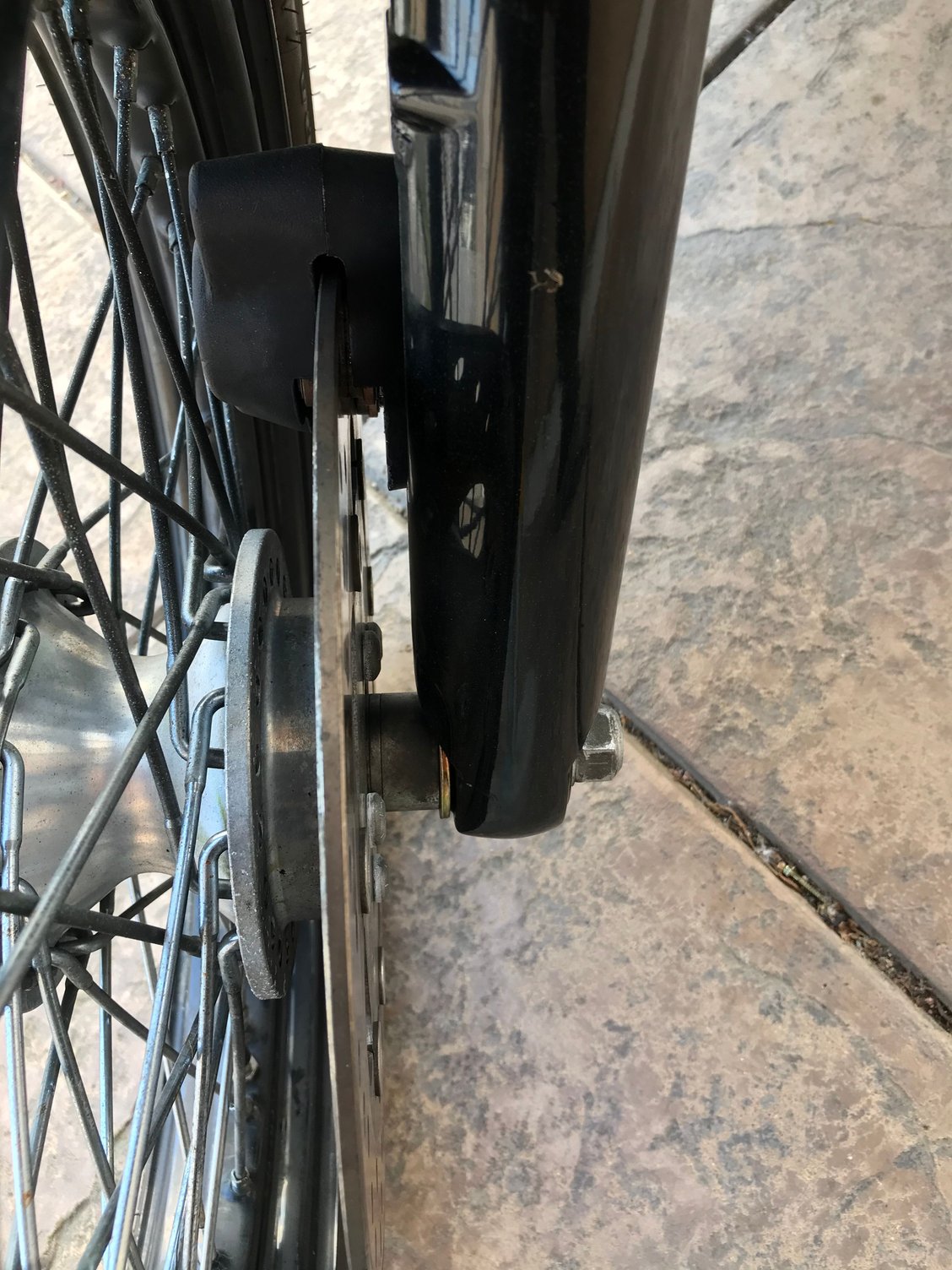

So I purchased a 2012 FXDB with a lot of oxidized parts. Especially the front fork sliders. Purchased black powder coated replacement fork sliders for 06-up Dyna.
Now in order to get wheel back on I had to add two 1/8” spacers on caliper side(disc won’t fit in caliper anymore). Why? It just feels wrong and now my wheel doesn’t look centered under fender. Don’t like it. Can anybody chime in explain why this happened? Or how to fix it right? It has a spacer on each side of axle the same size stock. Now two added washers on caliper side.

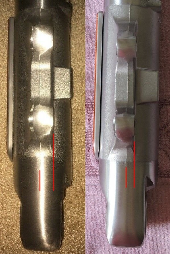

This is the difference your looking for ...
Now you'll know how to prove to your "Seller"

Thanks for the photo! Much appreciated. Now to figure out how to remedy my shituation. It’s sounding like that’s my problem. Spacing out the wheel is just going to make my wheel off center. It’s not very noticeable. But I see it, and it bothers me. That’s why I’m here.
