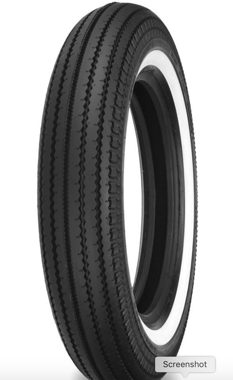

Shinko 270 white walls on my '86.
I think the rear is a little narrower than stock.
And if you’re looking for vintage vibe that’s what you want..

I will add that I've gone over drawbridge grating with no issue, but I notice on a stretch of the interstate my me where it was redone in concrete and has those grooves cut in it that you will notice a slight movement in the handlebars from the tread following the grooves. Since I typically don't ride that bike over 70 anyway, it isn't an issue, but I do notice it when I hit that pavement.
