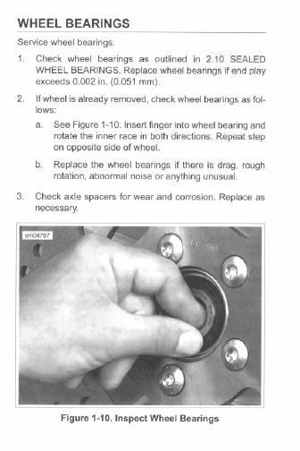

Well, I guess this answers it (taken from the maintenance manual):

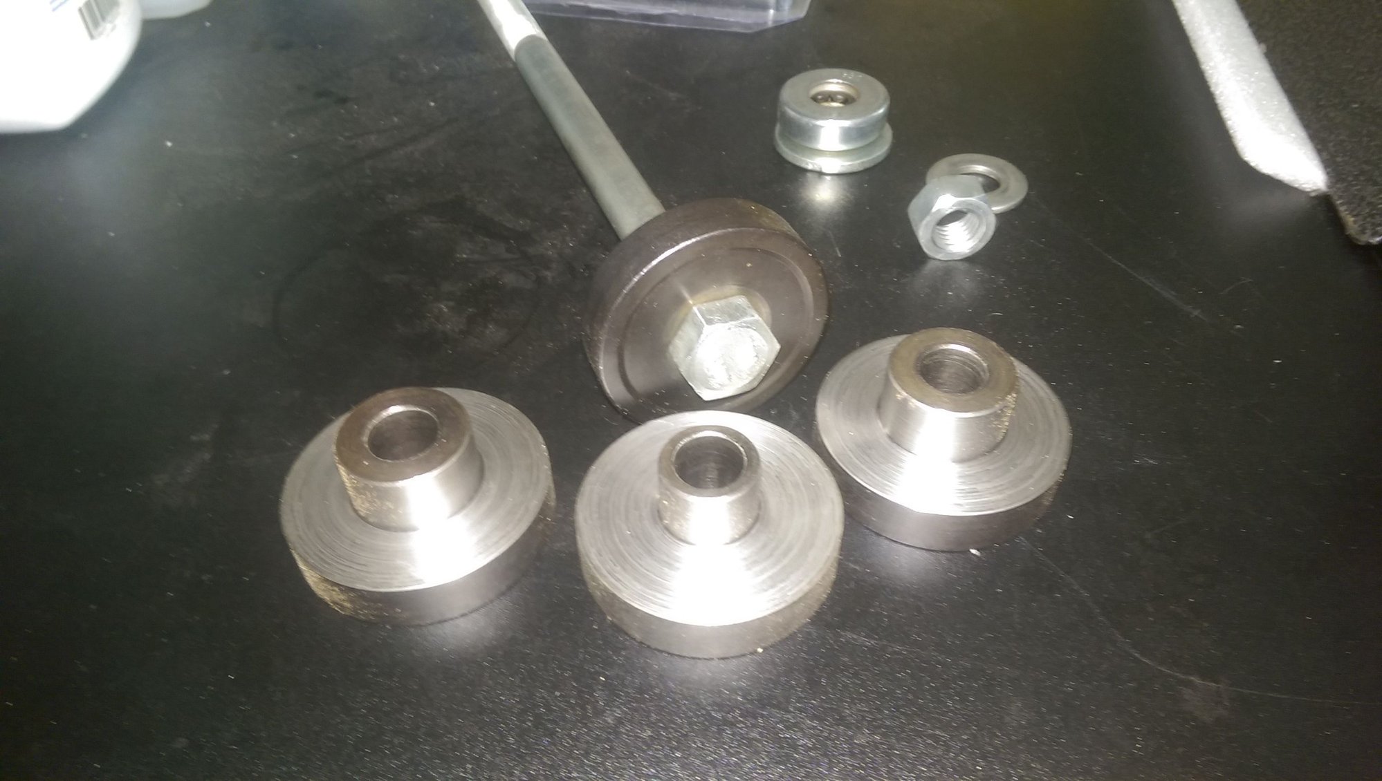

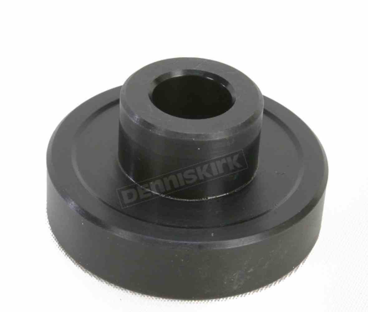

If it's a little snug I wouldn't worry but if they are hard to turn, I would.
If you used an aftermarket wheel bearing installer. There is a good chance you may have forced the to bearings too close together and put too much side load on the bearing..
If you look at the installer pics, a lot of tools have a ridge that presses the bearing on too far. I've gone in and machined the lip off. The kent moore kit that HD uses does not have the lip.
Wrong
Right..

Just flip the installer side of the tool so the flat side is against the second bearing during install. That will allow you to feel the inner race contact the axle sleeve. That's when you stop.
As BW said, if you can't turn it with your fingers, I'd start over.
