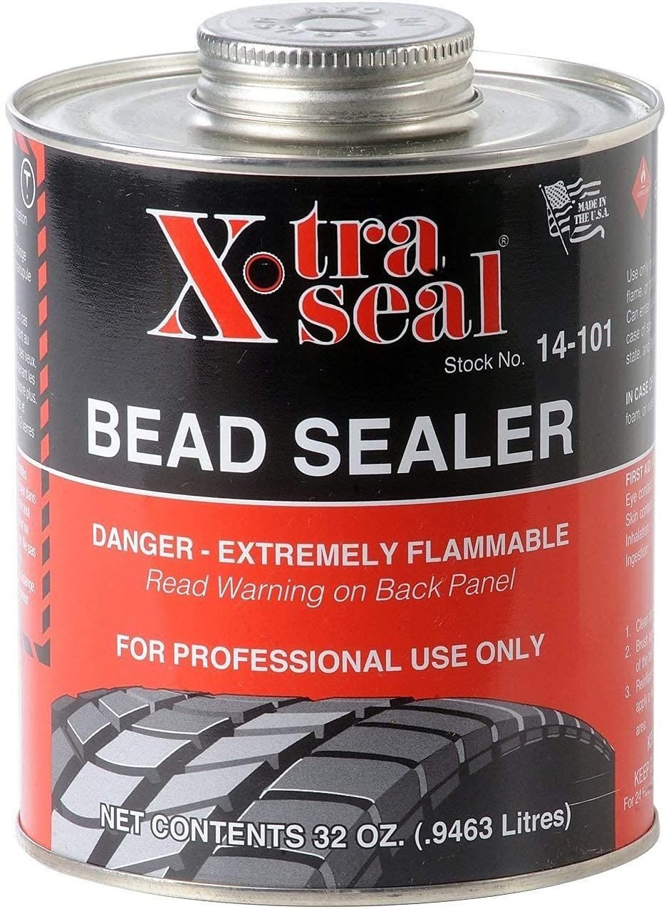

You could try some bead sealer; however, the next time you take the tire off it may need to be cleaned off.
Clean the are good to remove any loose chrome.

https://www.amazon.com/Xtra-Seal-Ext...s%2C100&sr=8-4
This is good stuff. I used it on some old rusty chrome ATV wheels. They sealed up and that's with just 6 psi of air pressure.
