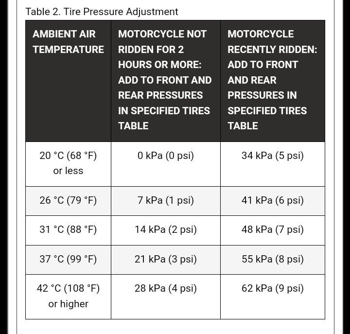

Hot Day Tyre Pressure.
In the 2023 Softail Owners Manual Page 48 table 24 it states front tyre at 20c 36PSI at 26C add 1PSI at 31C add 2 PSI. The way I read this page in the middle of a ride on a hot day I should stop and check the tyre pressure and adjust it to the recommended hot day temp pressure setting?
Or does it mean before I set out on a 31C day I should pump the tyres up to 38 PSI? That absolutely makes no sense either.
Who would mess around trying to get the pressure right on a hot day in the middle of a ride? There has got to be a better way.
In the 2023 Softail Owners Manual Page 48 table 24 it states front tyre at 20c 36PSI at 26C add 1PSI at 31C add 2 PSI. .
Why would you add psi when the tire is warmer? isn't this backwards?
I would say it's more for "expectations" when "checking"

Recent (2020+) owner's manuals have included the following tire pressure adjustment table. Prior to 2020, the owner's manuals made no mention of a "motorcycle recently ridden".
I interpret the above table as adding the indicated psi numbers to the numbers in the "specified tires tables". In other words, you're not physically adding pressure with an inflator.

WOW.. I am surprised with those air pressure charts and details, you would think air pressure in tire threads will soon be like oil threads. ??? ???
That first statement...'Motorcycles not ridden for 2 hours or more:'
That would make more sense if it was ...'Motorcycles not ridden in the last 2 hours:'
When I read the chart as written, first thought was exactly opposite of what they are saying.
