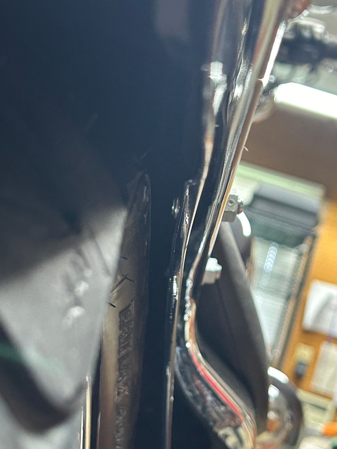

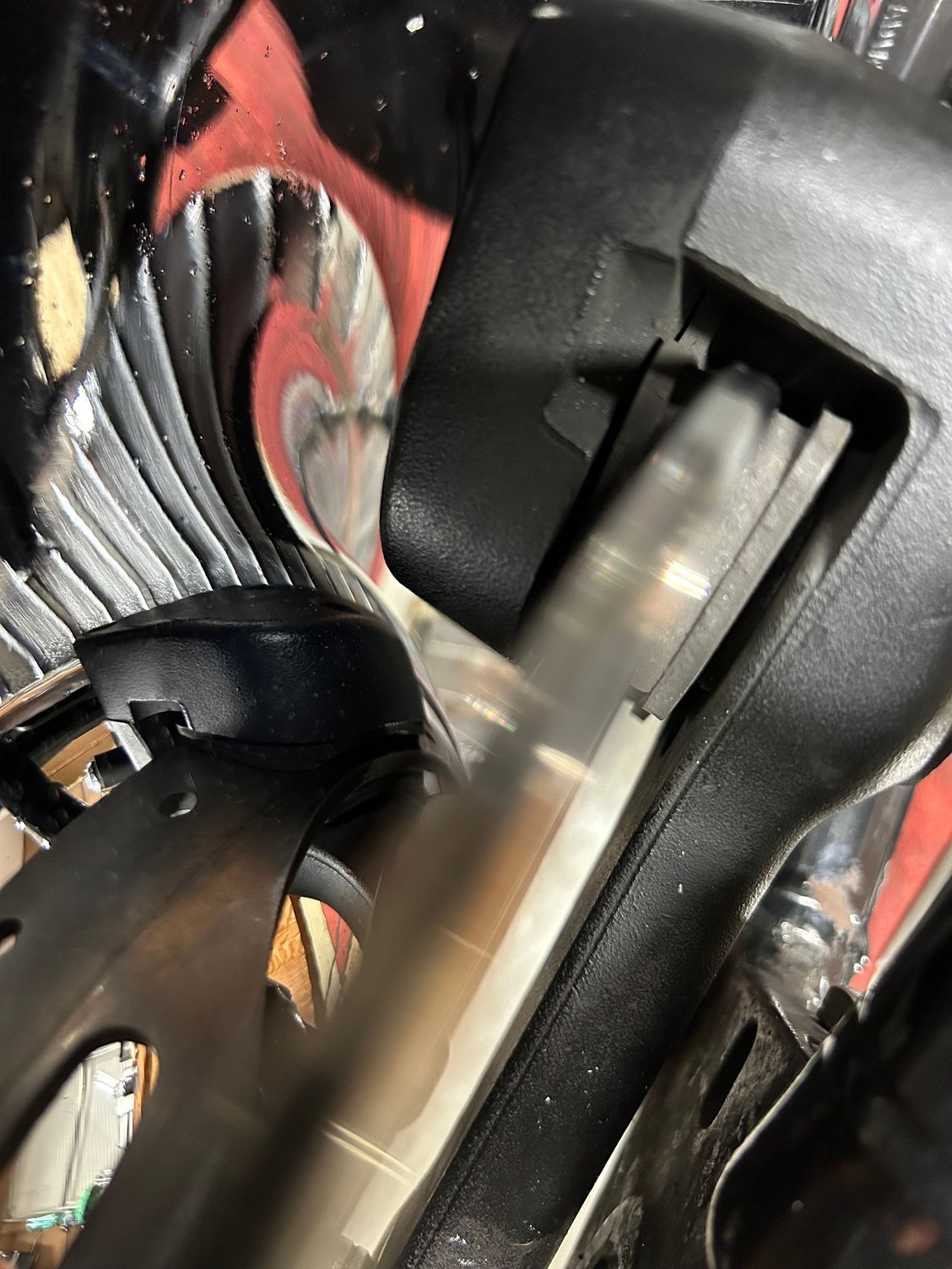

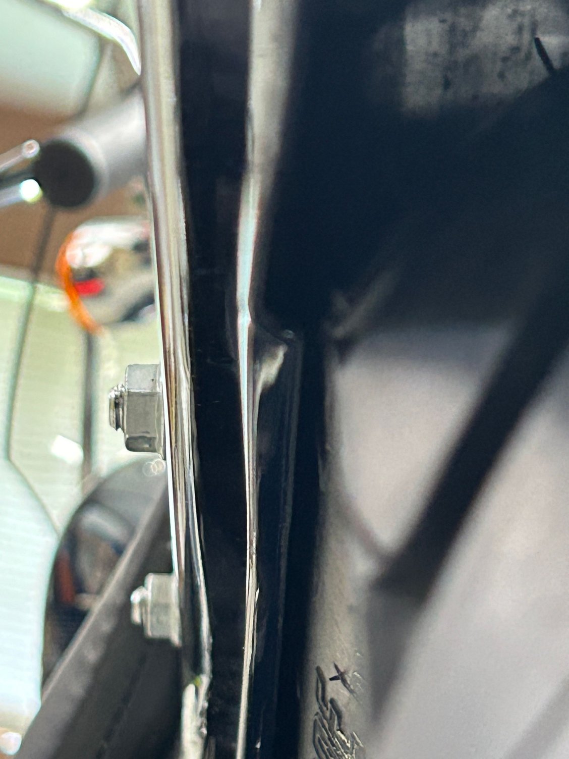

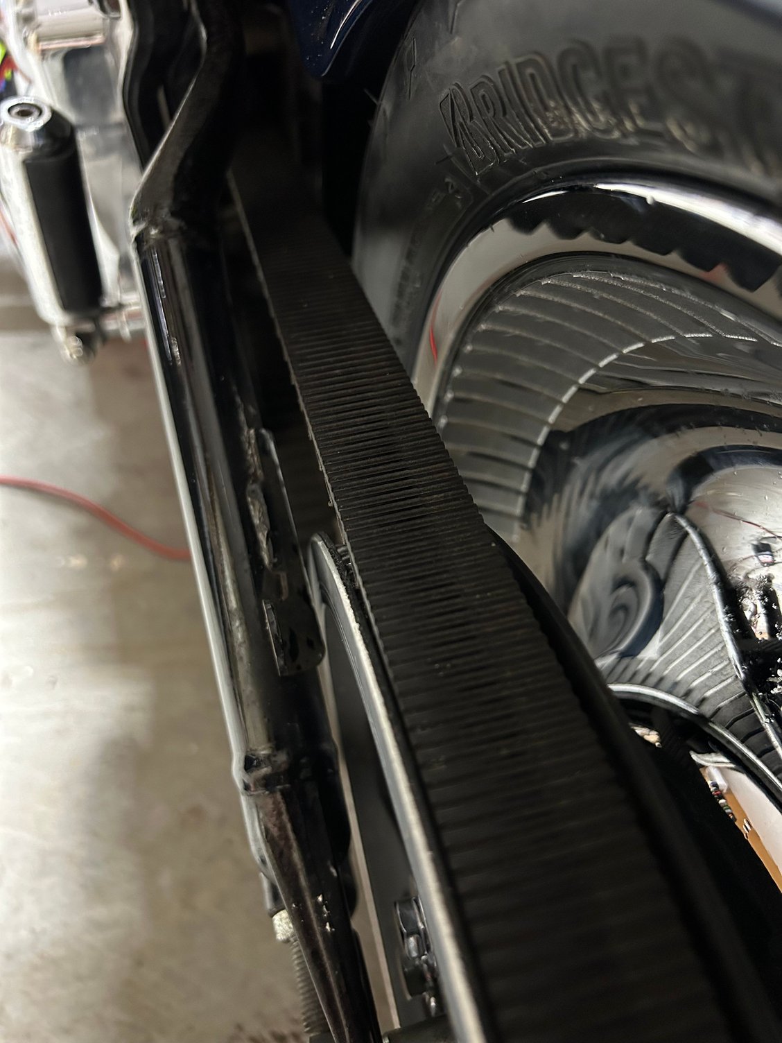

Update: It fits, barely. Had to turn the strut bolts around, I think it’s safe to say we knew that. This is the bridgestone battleax 170/60/17 like meatball used. I may try to see if I can order some spacers and walk the wheel over slightly to give some room on the left side, it would also push the wheel closer to center. Opinions? Thanks
Left, sprocket side
Right, brake side

... I may try to see if I can order some spacers and walk the wheel over slightly to give some room on the left side, it would also push the wheel closer to center. Opinions?
The concern would be that with only a change in spacers, you would also be changing the positioning relationship of the Rotor within the Caliper (pulley isn't as critical) ... How good is the Rotor centered now? However much you move the wheel, the rotor would be moving the same amount within the caliper.
Depending on how movement is needed. To do it right, you would then remove material from the rotor mounting surface on the hub to keep the rotor centered.

Belt clearance
Rotor/caliper spacing
Thanks for your insight multi, I'm thinking the area you are saying to mill away to do it correctly would be the wheel itself where the rotor mounts? I think just moving it to the right 1/8" would be good.
