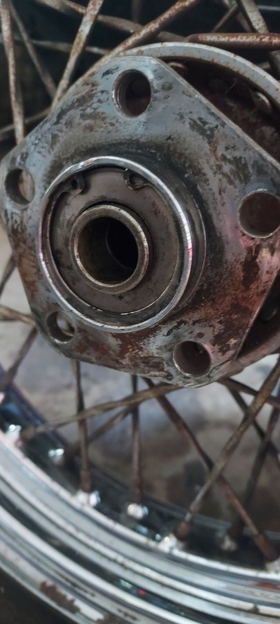

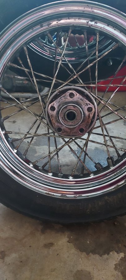

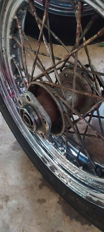

I've got a, presumably, aftermarket twisted spoke rear wheel. I think it came off an early softail but I'm not really sure.
Anyway, it has taper roller bearings & a shouldered spacer on either side, held in place with a steel washer that fits perfectly into the hub center & is locked in position with a circlip (snap-ring?) I can't find a part number on it anywhere.
One of the spacers is damaged & I'd really like to find a replacement, without having to go to the trouble of turning one up on the lathe. The wheel is a great fit in my 1990 sportster & would be perfect in the hardtail frame I have ordered. I know I'm going to have to pay around with the end play on the bearings (I'll be replacing them) but I could really use this one spacer to get everything lined up, temporarily.

A picture of what you have might help identify it.

That looks like a fairly standard 16 x 3 dual flange wheel. They used taper wheel bearings with a spacer between the bearings to set the play, and seal spacers on each side.
The only problem of identifying it more is that style of wheel was used from the early 70's through the 90's, but with different offsets (rim to hub) to fit a specific application based on sprocket and brake rotor spacing. It sounds like what you are looking for is at the link below, which includes bearings. But again, if you plan to reuse that wheel you need to be certain the offset for that wheel matches your application.
https://www.denniskirk.com/v-twin-ma...prd/124163.sku
If all you want is the seal spacer, you could look on ebay.
Paul
Paul

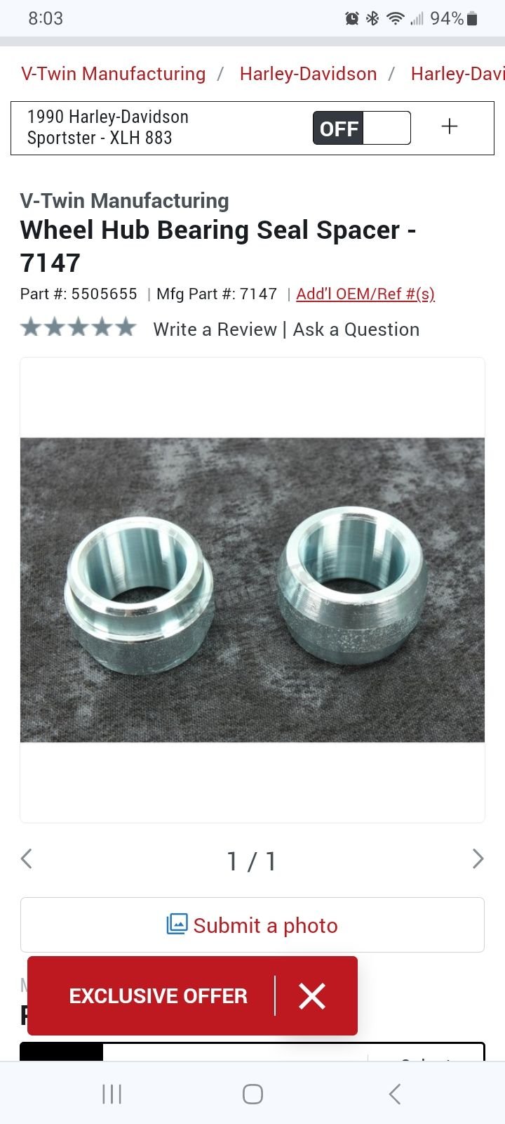

SEAL spacer! I didn't think to look for that. I thought all wheel spacers were called wheel spacers. The seal spacers in that kit & straight tubes. The ones in this wheel have a step.
Away to ebay we go! Thank you!
