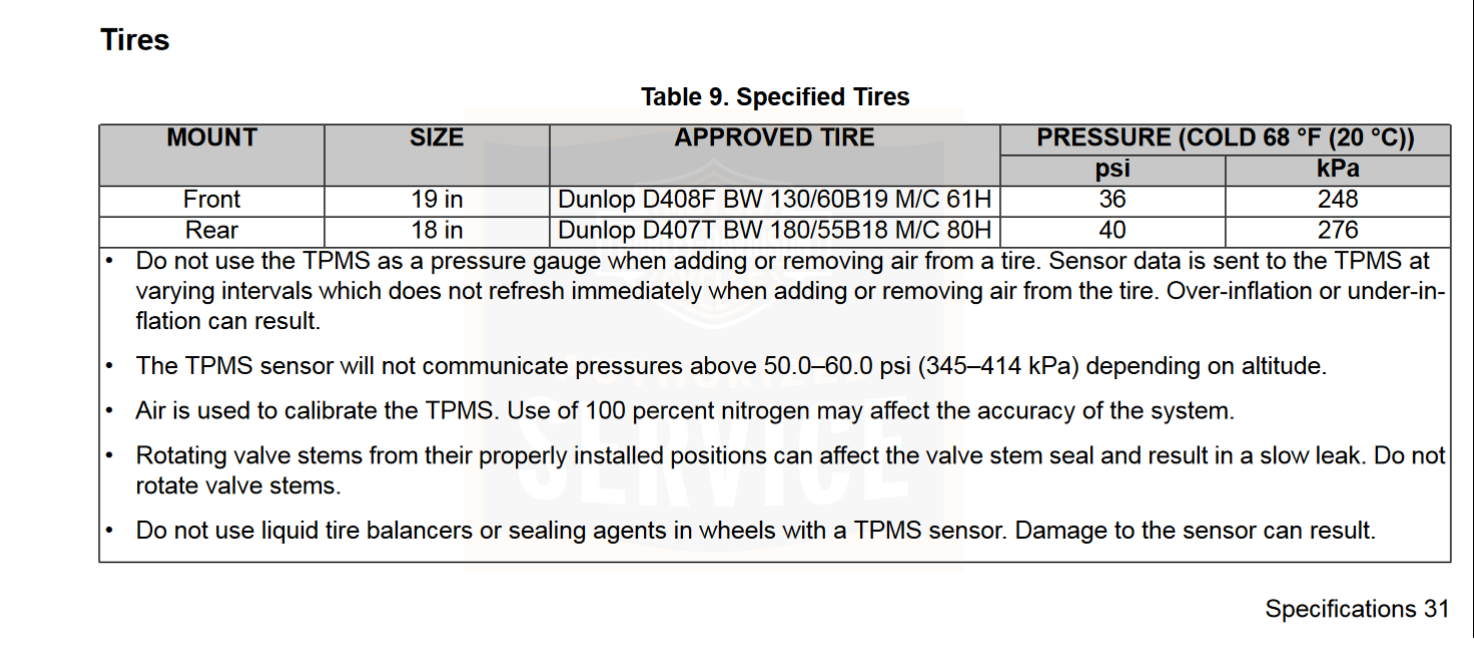

For informational purposes, Harley, in the owners manual, states, do not use balance beads, or the like in wheels with TPMS sensors.

Harley's' owners manual didn't make reference to big trucks......and I re-read the document. My mistake, it was liquid tire balancer they frown upon.
