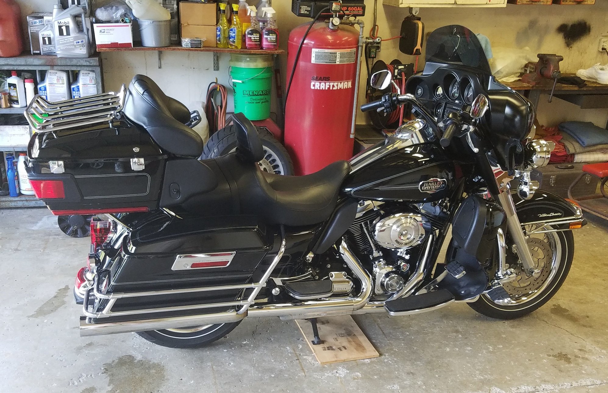

Incredible timing on your post, I spent several hours just last night cleaning the wheels and spokes on my most recent purchase.
For the front wheel I used Never Dull and painstakingly polished each spoke individually and wiped them down with a microfiber towel. They turned out great, but it was very tedious, and it was difficult to reach the parts of the spokes behind the brake rotor, and where the spokes cross each other.

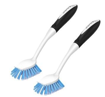

The spokes on the rear wheel were more difficult to reach with the drive pulley, swing arm, etc. in the way, so I used McGuires Chrome Wheel Cleaner and a long-handled dish brush instead. (I bought a "spoke" brush from H-D a couple of years ago but it's too flimsy to be of any use) With the dish brush I was able to reach through the spokes on each side to get both sides of all the spokes and the hub. I also lifted the rear wheel off the ground slightly with a jack so I could rotate the wheel as I worked. Afterwards, I rinsed them thoroughly with water, and they turned out as good as the front spokes.
The chrome cleaner and dish brush are a great way to make them look better quickly, and they turned out better than I expected. When I have more time, I plan do a more thorough cleaning/polishing using the shoestring method suggested by chopper_man, but for now they look MUCH better than they did.
