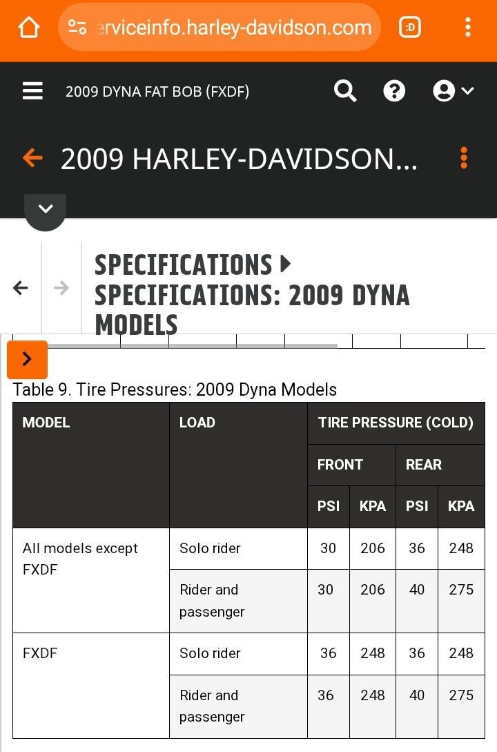

They are both right, and both wrong. It very much "depends".
As mentioned, the sidewall pressure is a maximum pressure, for a maximum load. The owners manual is a recommended pressure for the oem tire, under whatever loads they estimate, and for average riding conditions.
Different tires, different loads, different riding conditions, and you really should adjust pressure for that. Gonna load up for a month on the road, you'll likely want higher than normal tire pressure. Going to spend the day crawling around on jeep trails and sandy beaches, you're going to likely want lower than normal pressure. Switched to a different tire, you'll likely need to learn what works for it best.
Personally, I treat tire pressure as a tuning tool, and will adjust it based on the variables, and how the bike and tires are responding. I happen to be running higher than stock on my bike with these tires, because the lower oem pressure results in the rear tire getting hotter than I like on the highways, and the bike is a little swishy at that lower pressure.
Since you alluded to having some problems, I suspect you might benefit from trying some higher pressures. I would also strongly recommend a notebook to keep service and tuning records in. That way you can reference it at a later time, when you no longer clearly remember what you did, and what the results were from that.

For clarity, this is from the OP's Owner's manual.
