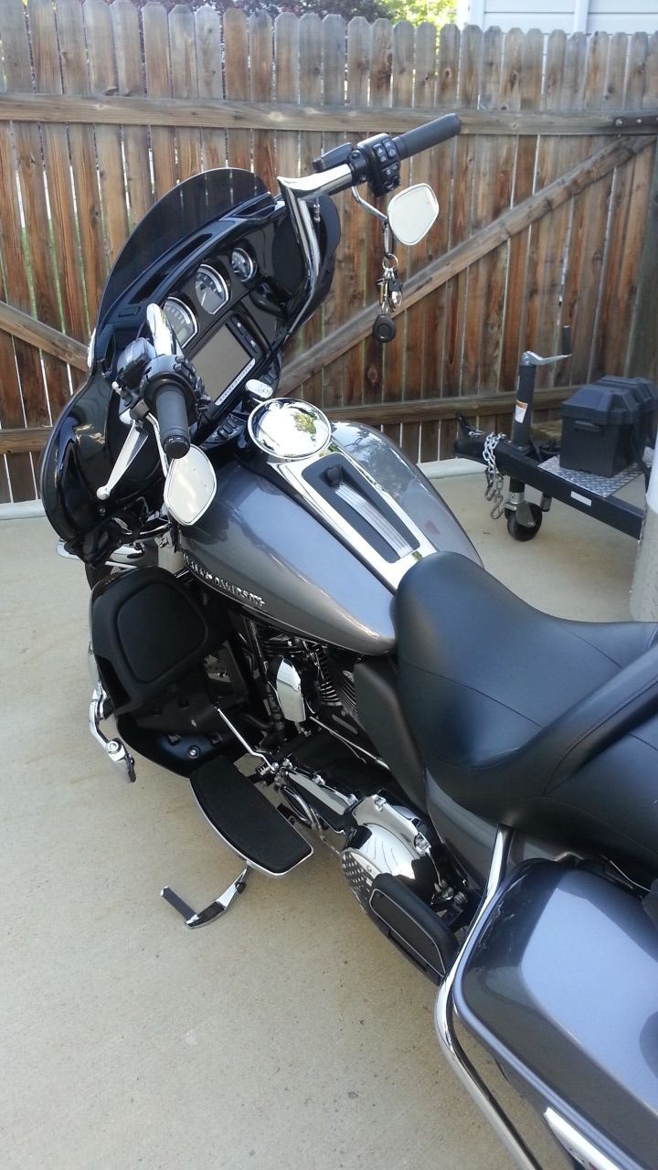

OK...after 2 days, I finally figured out my problem...I went and bought the screamin Eagle TBW kit....no green connector, its a straight shot, although the pins are male...need to be female...no big deal....spliced in the female plug/solder/shrink wrap...plugged it in...fired right up no issues! so....I began putting everything back together, checking as I went....as soon as you turn on the ignition...if the cruise light comes on...you have no throttle...so..bad solder joint? not....it's that stupid female molex connector! you wiggle that plug around and everything works...move the harness an inch...no throttle...Im going to take it to the dealer and have a new connector installed....this should be a warranty issue....in fact I think there was a TSB on it...other than that...everything looks good..I do know, I could do this in my sleep....for anyone doing this,here's a tip...use a chain for running your wires....I taped the bundle about every 4 in or so...and used some of the old lady's lube....they slid through like butter ...bars are sweet...also had to do a little grinding on the switch console and fairing...no big deal used a die grinder with a sanding wheel...oh, also....while you have the bike apart...be ready to pay attention to the clutch and brake lines...there are some zips that need to be cut to give you more length...its easier with the bars off than on....believe me...oh I am also using my stock heated grips, you'll have to extend this wire..it is not long enough...

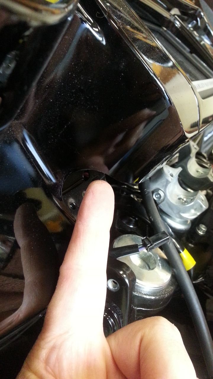

This is where you need to clearance the fairing if using the Vindiktas...they're fat

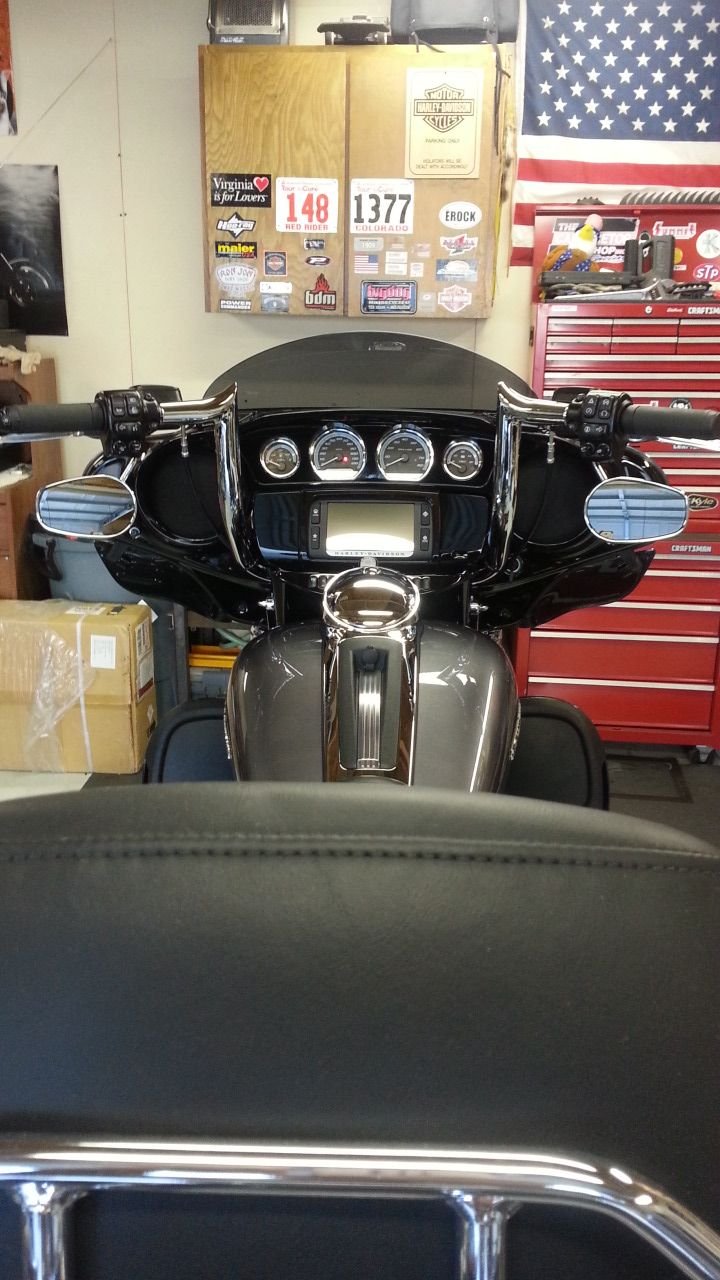

Here you go...these are 12's
