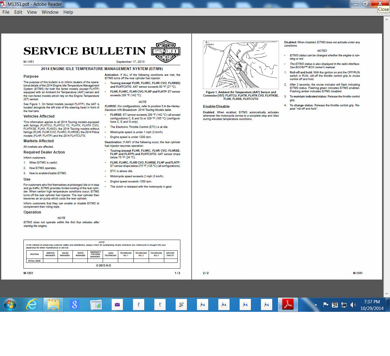

Originally Posted by shore
It's taking the intake air temperature and that has less to do with ambient air temp than you think. That air around the engine is a lot warmer, hence the dang thing on at every light.
turn it off.
No sir.
Read that bulletin once again. It clearly states AAT, not IAT
.....On faired models (except FLHTP), the AAT is
located alongside the left side of the steering head in front of
the fuel tank.....
.......Activation: If ALL of the following conditions are met, the
EITMS turns off the rear cylinder fuel injector.
• Touring (except FLHR, FLHRC, FLHR CVO, FLHRSE)
and FLHTCUTG: AAT sensor exceeds 80 °F (27 °C)
• FLHR, FLHRC, FLHR CVO, FLHP and FLHTP: ET sensor
exceeds 288 °F (142 °C).......
Deactivation: If ANY of the following occur, the rear cylinder
fuel injector resumes operation:
• Touring (except FLHR, FLHRC, FLHR CVO, FLHRSE,
FLHP and FLHTP) and FLHTCUTG: AAT sensor drops
below 75 °F (24 °C).
• FLHR, FLHRC, FLHR CVO, FLHRSE, FLHP and FLHTP:
ET sensor drops below 275 °F (135 °C) (all configurations).
• ETC is above idle.
• Motorcycle speed exceeds 2 mph (3 km/h).
• Engine speed exceeds 1350 rpm.
• The clutch is released with the motorcycle in gear.
The IAT actually does read quite a bit higher than AAT.
I display both on my PV2, for curiosity's sake.
I don't know why theirs is coming on below 80 however....
