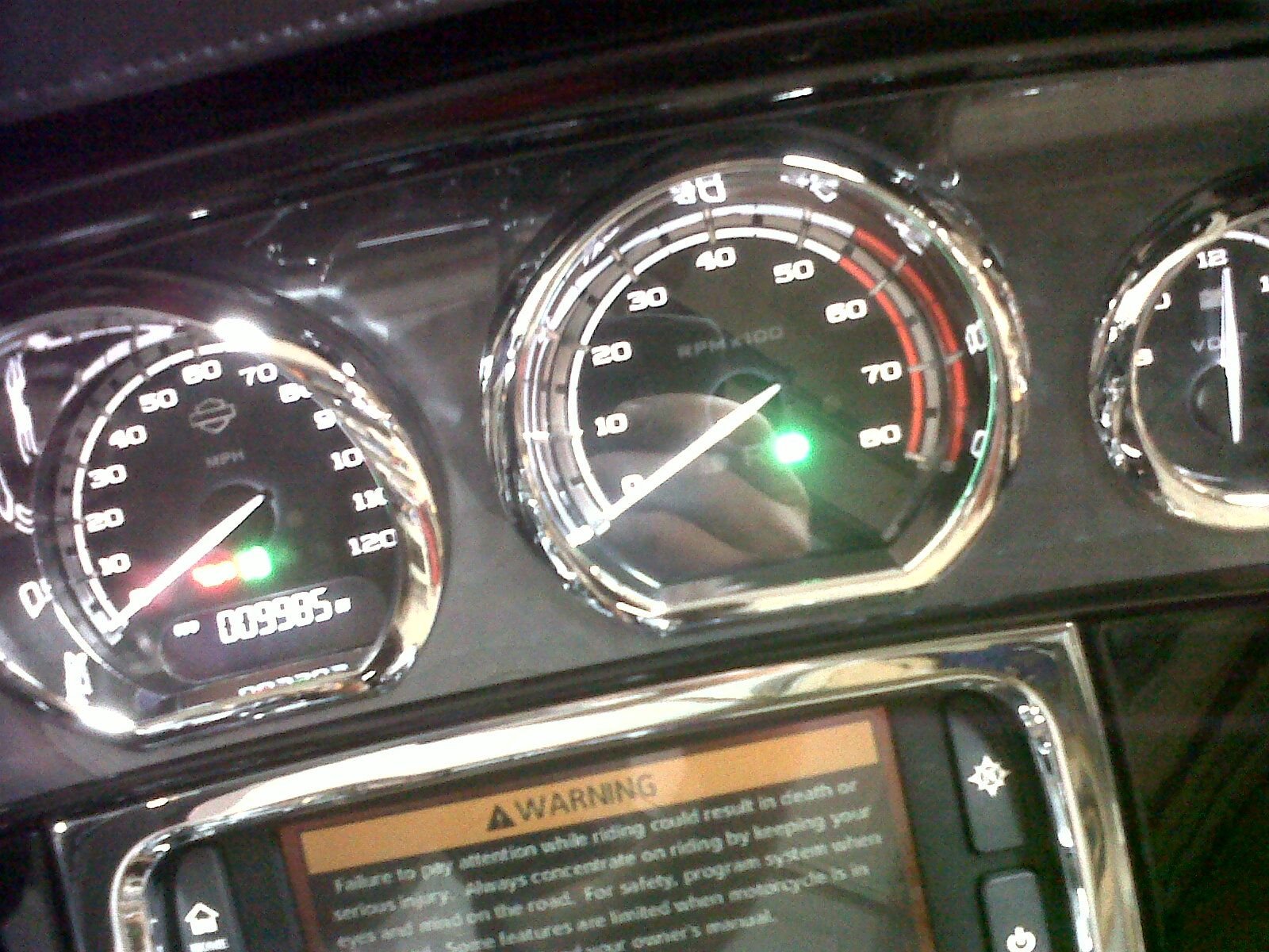

Hello,
To keep your AUX on while high beams are on the dealer just need to go into the BCM and activate that. There is also an indicator light in the RPM gauge that you can get active in the BCM that shows you when the AUX lights are on. It take about 15 minutes to do and my dealer did it for FREE.
