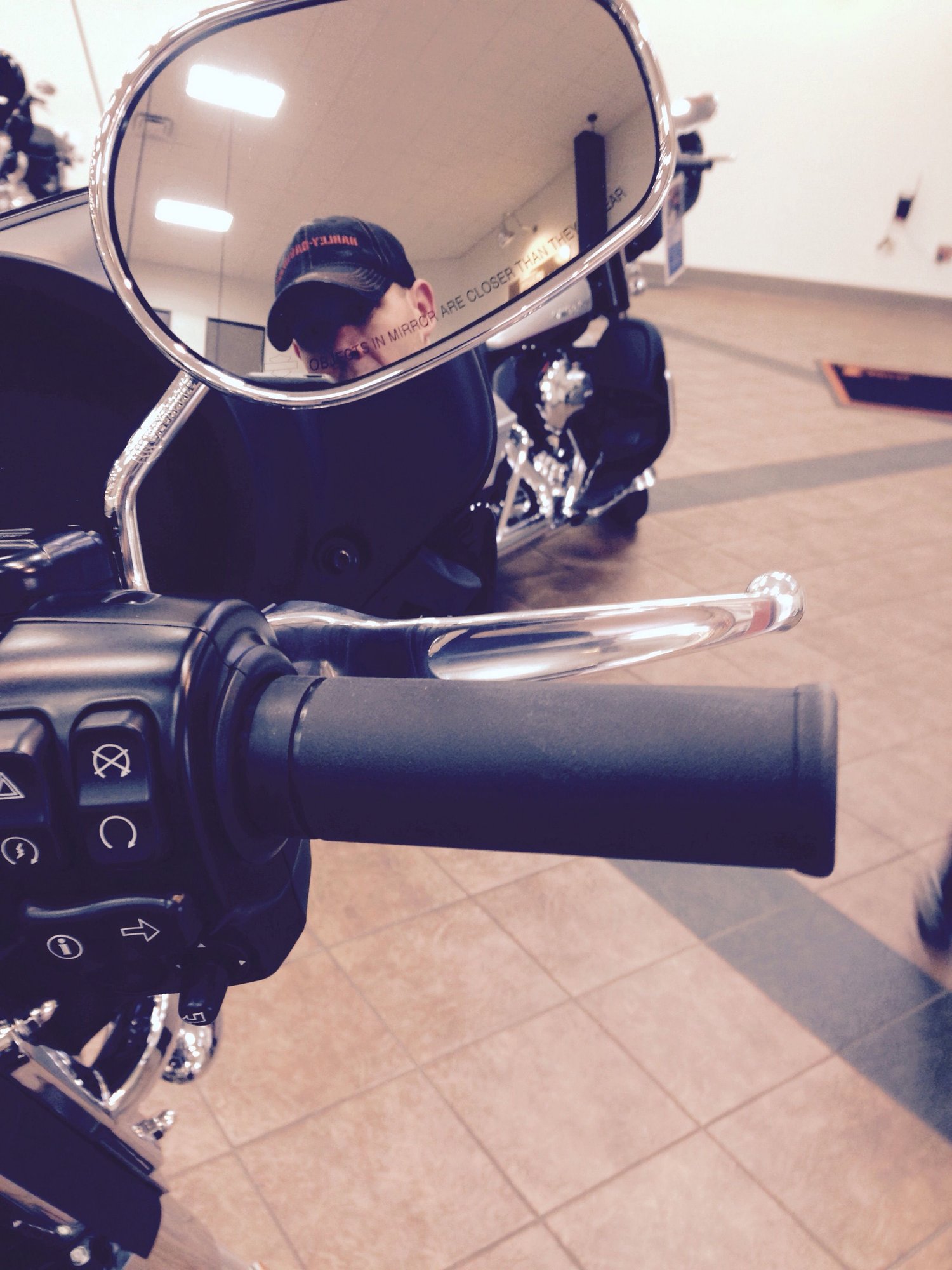

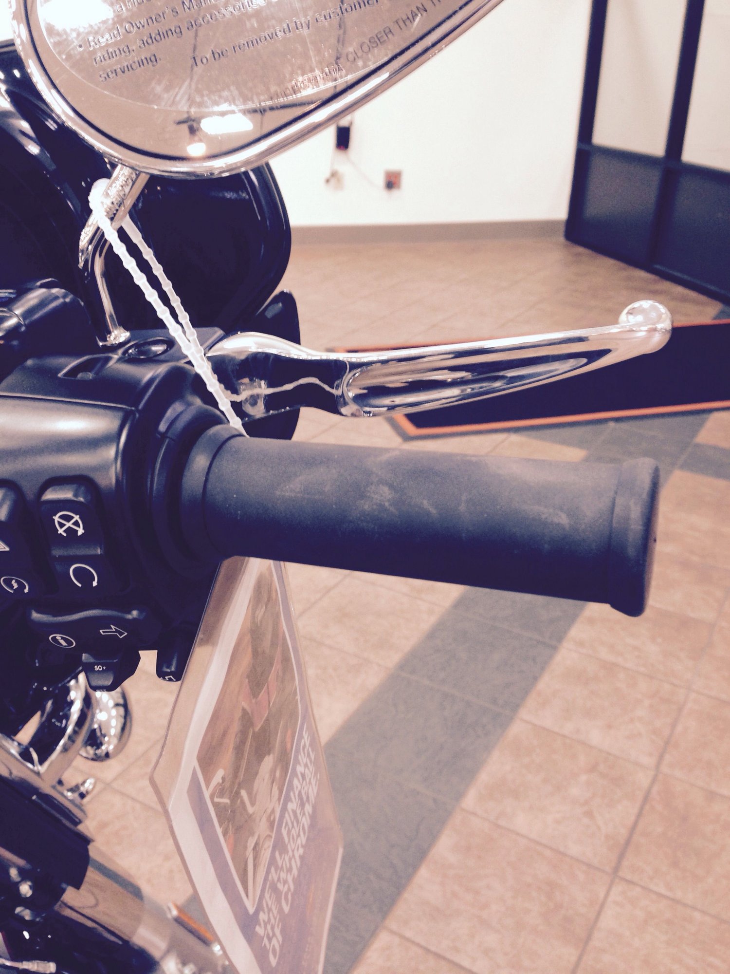

Here is a comparison pic of the Ultra Low and Ultra Classic grips
Ultra Low
Ultra Classic

The ultra low model grips are smailer in diameter, andf the bars provide an additional 2" pull back. The grips are not heated. It's all part of the "Ultra Low package." The seat sits 1" lower and the frame another 1". The derby and primary covers have a more slim profile and the windshield height is reduced. The parts link shows heated grips are available, but I believe you would need a competent parts guys look up the OEM parts number for the reduced diamter grips.
