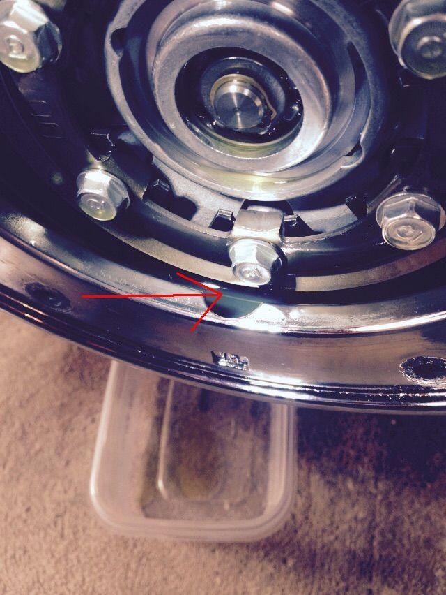

Thanks for all the info! I put a few pieces of wood under the stand to get the bike close to level not completely level but pretty close. I then drained and refilled with 38oz.

So what Is the verdict? refill on the Jiffy stand? It makes a big difference between the two, I usually fill It until the oil reaches the clutch basket. I changed out my derby cover the other day while the bike was level and It looked like It needed oil, but when I lowered the bike back to the jiffy stand It was right on the money.

When you say fill till the fluid reaches the clutch basket are you referring to the area the arrow is pointing at? If so the fluid reaches and covers that. I think I am good with the 38 oz. I just don't want to mess anything up. My OCD really kicks in when dealing with fluid levels.
