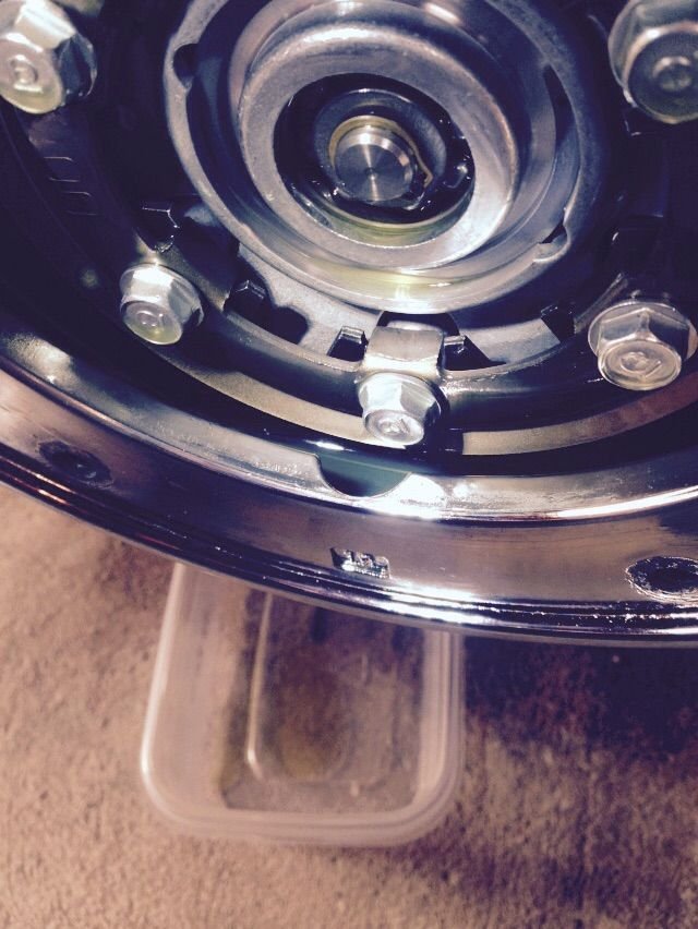

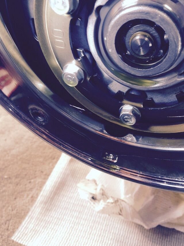

Hello, changed the primary fluid out today for the first time on my SGS. I let it drain a hour or so and refilled with 38oz of fluid. The level before draining seemed higher than it is now with 38oz in it. I'm guessing the dealer added too much when prepping the bike? I just want to make sure Im good or if I should try and match the beginning level?
Hard to tell in the pics but the beginning level is noticeably higher.
Before drain and refill
After refill with 38oz

Just did mine and added 38 ozs. as per the manual. If I remember correctly the manual says the bike should be upright (level) when filling, could you have drained on the jiffy stand and filled upright (level)? If so the level on the jiffy stand would have looked higher...don't mean to state the obvious, just trying to help.

As IUOE ROB said, if drained while on the jiffy stand, more than the 38 oz's could have drained out. It looks to me from the pics that the fluid level is correct before drain and low after refill. Which will cause more than difficulty finding neutral.
I don't remember if I read it in a manual or if someone told me, the fluid level has to be high enough for the clutch plates to be just touching the fluid.
