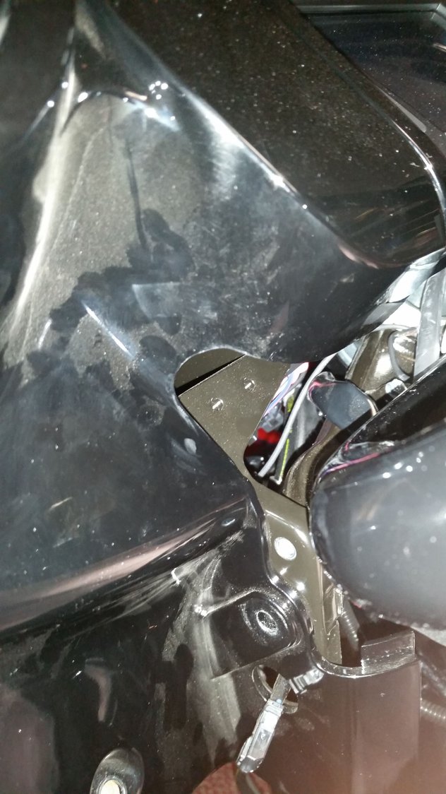

It's a big deal because first of all I bought these Bars only expecting to trim 1/8" of the lower fairing cover over the igniton. Then I get the bars and notice I will have to trim the upper fairing to sit over top of the bars correctly. When I tell Joe this im told that this is NOT NEEDED and I must have a defective set of bars. He said I can send them back for another set which I did and that pair is the same. Again since according to him this isn't right I'm returning them again...... So what your telling me is don't listen to the manufacturer of these bars and just start modding my fairing, which I'm specifically told NOT to do.

This is where my issue is this slot just isn't big enough to fit over the bar enough to bolt down the fairing
