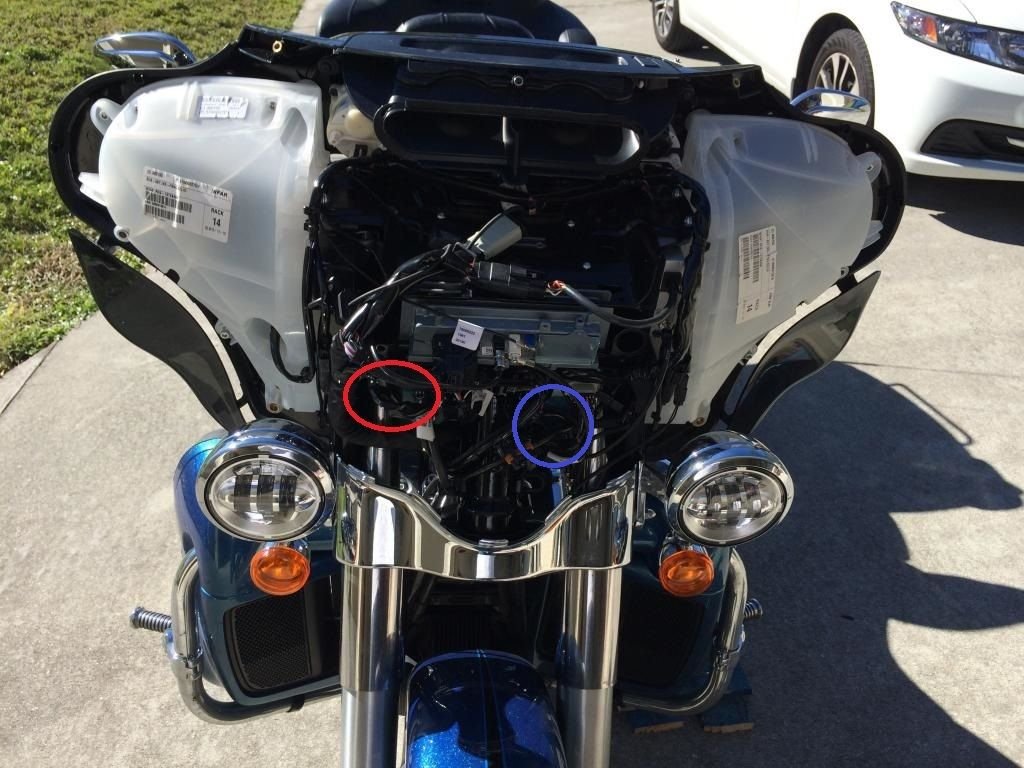

Anyone know where the TBW is located behind the faring? I have the book with wiring diagram but that's like trying to reading another language.
Trying to hook up these @@#@$#$ Heat Demons!

TBW or heated grip plug?

Looking at the bike from the front, it is a set of wires, wrapped in black tape, that comes over the top of the triple tree, crosses down and to the left, under the speaker pod. 6 wire plug. The heated grip power should be right next to it.

Got to unplug and pull the TBW out enough to get the heat demons inside the bar.
Do I have to remove the speaker pod to see the wires?

No you do not. Look straight down from the dash pocket.

The wires plug in under the radio.

It should be close to the circle.

Awesome thanks! I did manage to find the wiring in the diagrams and they are green/orange and grey/orange.

Are you looking for the TGS wires or the heated grip power? heated grip power is under the blue circle. (sorry for the previous mis-direction)

Looking for throttle by wire wires. Not using OEM grips.
