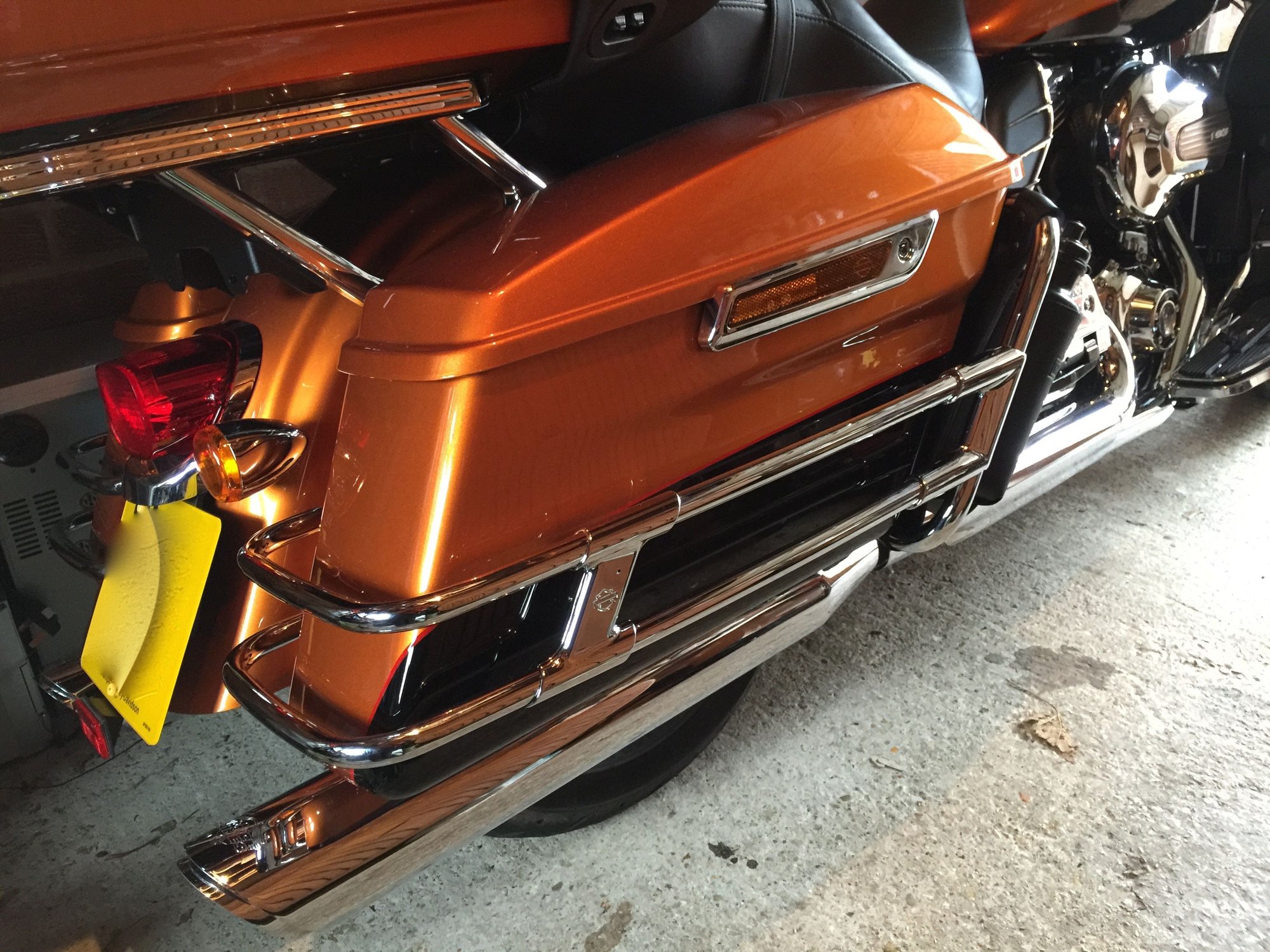

Added the saddlebag rails and body-coloured filler strips today, I learnt that the instructions were useless and that despite looking identical, each side seems to fit differently with different clearances when threading the filler strips down.
Worth the effort though, pleased with the result..

Take the rails apart it'll be alot easier. When you look at them you'll see what I mean. Some guys where taking the shock off when they first came out,said the rail wouldn't go through.

If you are putting in filler strips, you have no choice but to dismantle the bars.
Being a UK spec bike, I also had to remove the registration plate to I could thread the bars through, also the indicator on the left hand side of the bike sticks out further, so if you bolt the bottom bracket of the rail down, you can no longer thread the filler strip round - which doesn't happen on the right hand side - bizarre!
The biggest issue I had was finding a tool that allowed me get onto the torx bolt that secures the base of the filler strip, its easy to get a wrench on the nut the other side, but the clearance is really tight behind the strip. Luckily a friend who lives a couple of minutes away from me had just the tool that could fit in the 1" gap.
